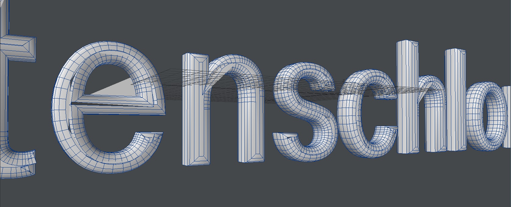

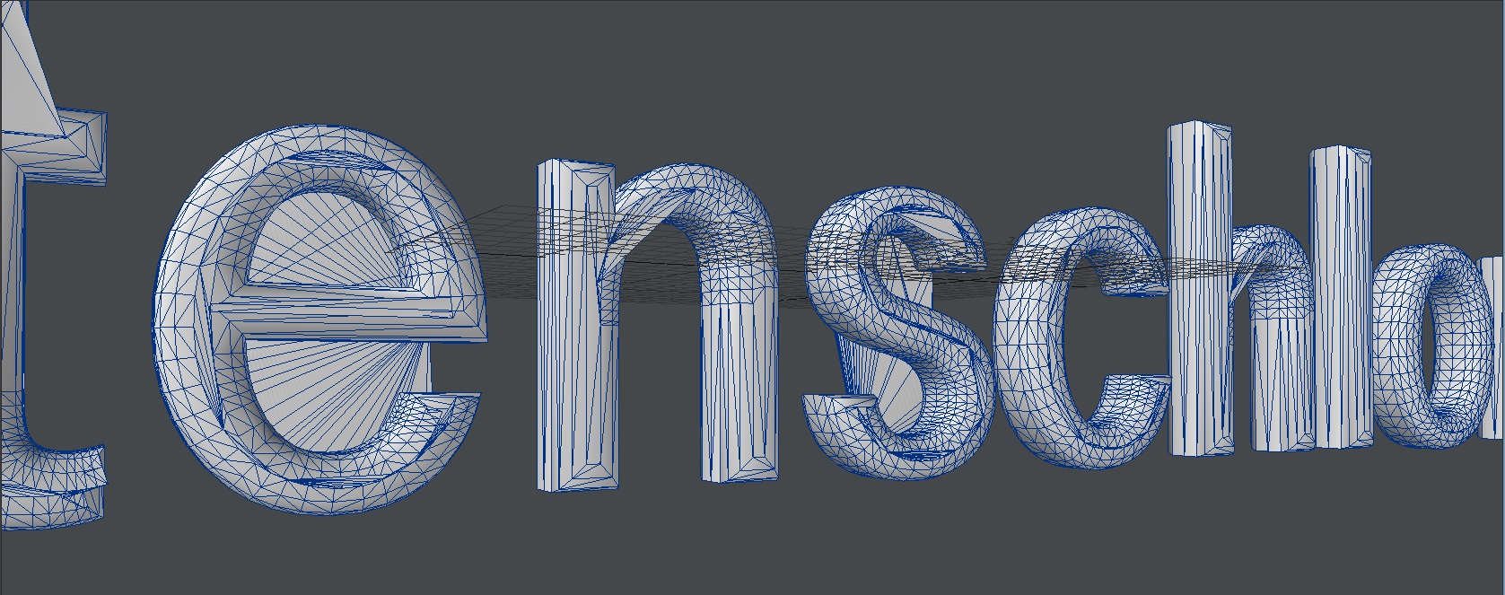

The crash is finally a LightWave problem, but anyway the issue is that your object has degenerated polygons, probably due to the beveling process, that FiberFX can't process. As you can see in the attached images, the object has polygons with a lot of problems (crossing edges and so on). If you triangulate the mesh the render works fine, but the triangulation is not right due to this degenerated polygons.
The only way to avoid this crash is to fix, remove or triangulate the polygons with problems.
