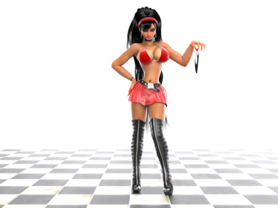

yes, Here rendering as 2048 x 1536. Here the record but if I zoom on the personal to rework in photoshop, eye , for example , it's not terrible , yet made ​​size is not bad what should I do ?

That render looks clear to me. I'm sorry - I don't understand the issue you are having.

I am not entirely satisfied, but hey I'll catch it in photoshop, thank you all the same Paul

Can you post a Poser render in comparison? Also- you can sharpen renders by reducing the Kernel->Filter Size.

yes it is Paul , as you say I Collapse kernel filter size and I have much more clarity , thank you.

To add to the above, there won't be a lot of eye detail on a 2k wide render with the subject so small.
