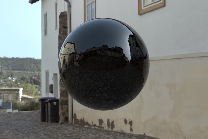

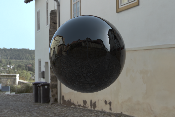

Tougher to judge with a b+w image, but here's a quick color test comparison in V-Ray.
V-Ray - Diffuse: 0, Specular: 1, IOR: 1.55
Octane - Diffuse: 0, Specular: 1, IOR: 1.55
So, everything seems normal here to me.

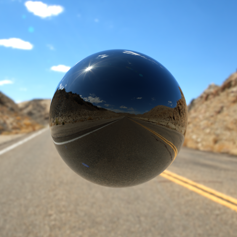

This is what I get in 2.22.2 with a black glossy sphere with an index of 1.55:

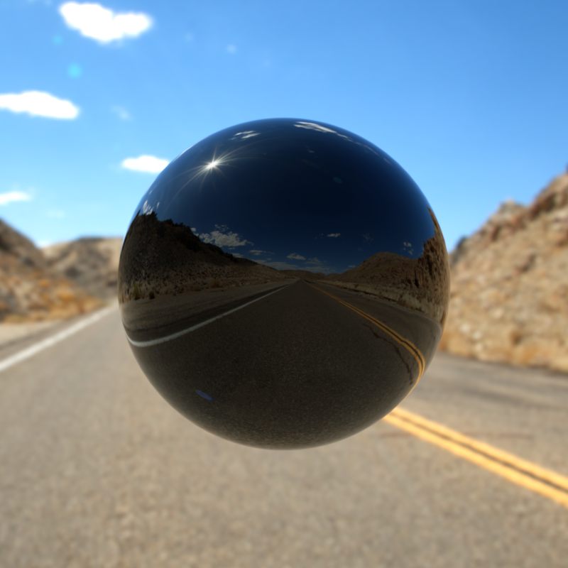

That's what you got in 2.21.1:
EDIT: Fixed the HDRI gamma and also uploaded a render from version 2.21.1.

abstrax wrote:This is what I get in 2.22 with a black glossy sphere with an index of 1.55:
It definitely changes when I change the IOR value, so I can tell it's not defaulting to 1. I just seems like the differences between normal and grazing are very low or something? Looking at the first sphere i posted, with no HDR environment, shouldn't the normal angle look much darker than that?
