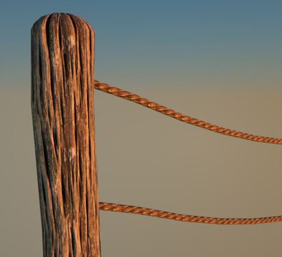

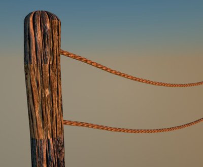

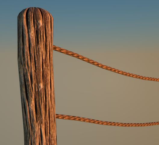

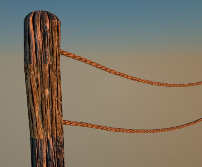

It seems smoothing is not loading correctly into IPR (can't confirm other renders...F9/F10 yet)
Can anyone duplicate this issue with the attached files?
Once loaded into IPR, I sometimes need to RELOAD the IPR scene several times to get smoothing to look correct. Using Beta 3.

It is a weird issue, it not looks like a smoothing problem. Anyway I can't reproduce it here.
Can you post or send to me the full scene with the .lws file?

If you take the textures off you'll see it's def a smoothing issue (at least on my end). Could be drivers I'm using...? 347.88 on my end...which are you using?
I'll setup a default scene and attach shortly. Again it doesn't happen every time...sometimes if it does happen I need to reload several times to get it to show correctly....if it is correct I may need to reload several times to get it to not work... FYI.
