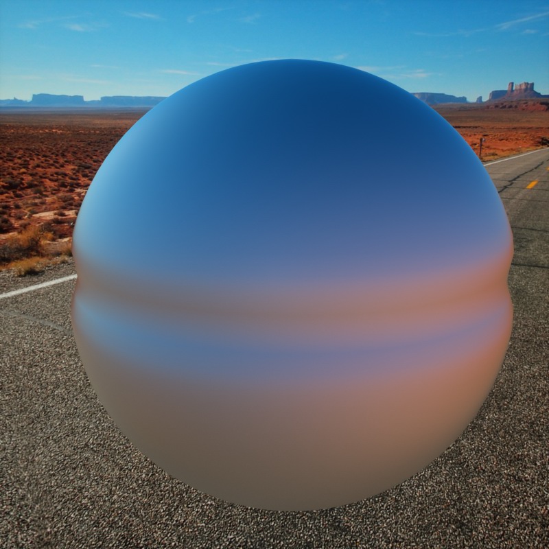

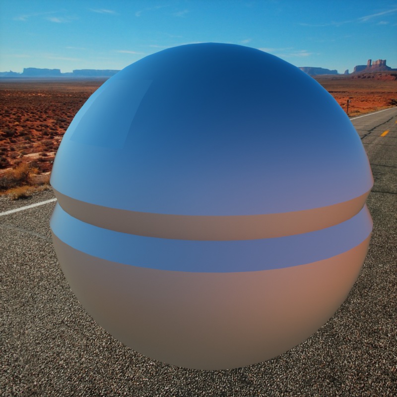

Look at the pictures this "load vertex normals" options turned on and off. Smoothing are very different and I've no idea how is better and correct.
Load vertex normals uncheked
Load vertex normals checked
Wireframe
I personnaly like when load vertex normals turned off. Result is more accurate.
What do you think?

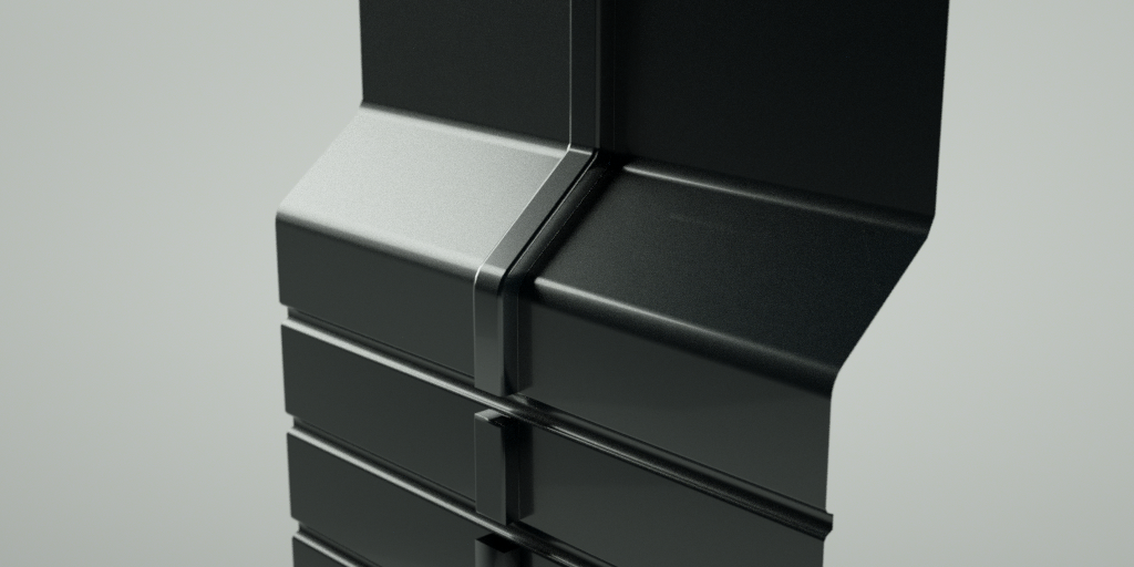

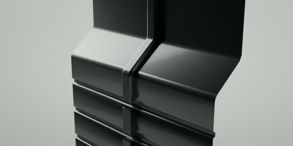

If you need hard edges on a smooth object a vertex map might be needed.
But I also always turn off the use of vertex maps as I use a lot of third party objects. An many have really strange vertex maps on them and I have no time to correct that. I use Octanes global smoothness and it works well 98% of the times.
Here's an example of a vertex map used on an object with split normals. Same object with vertex maps turned off.

I'm simple try to undarstand why reflection is so different on front lagre faces. And how I can control it.

You can control it with a vertex normal map. The strange reflection comes from strange smoothness (bulging). Hard to tell what is going on without looking at the OBJ.Dmi3ryd wrote:I'm simple try to undarstand why reflection is so different on front lagre faces. And how I can control it.
As I understand octane material smoothness didn't working if mesh initialy have smoothing groups.
