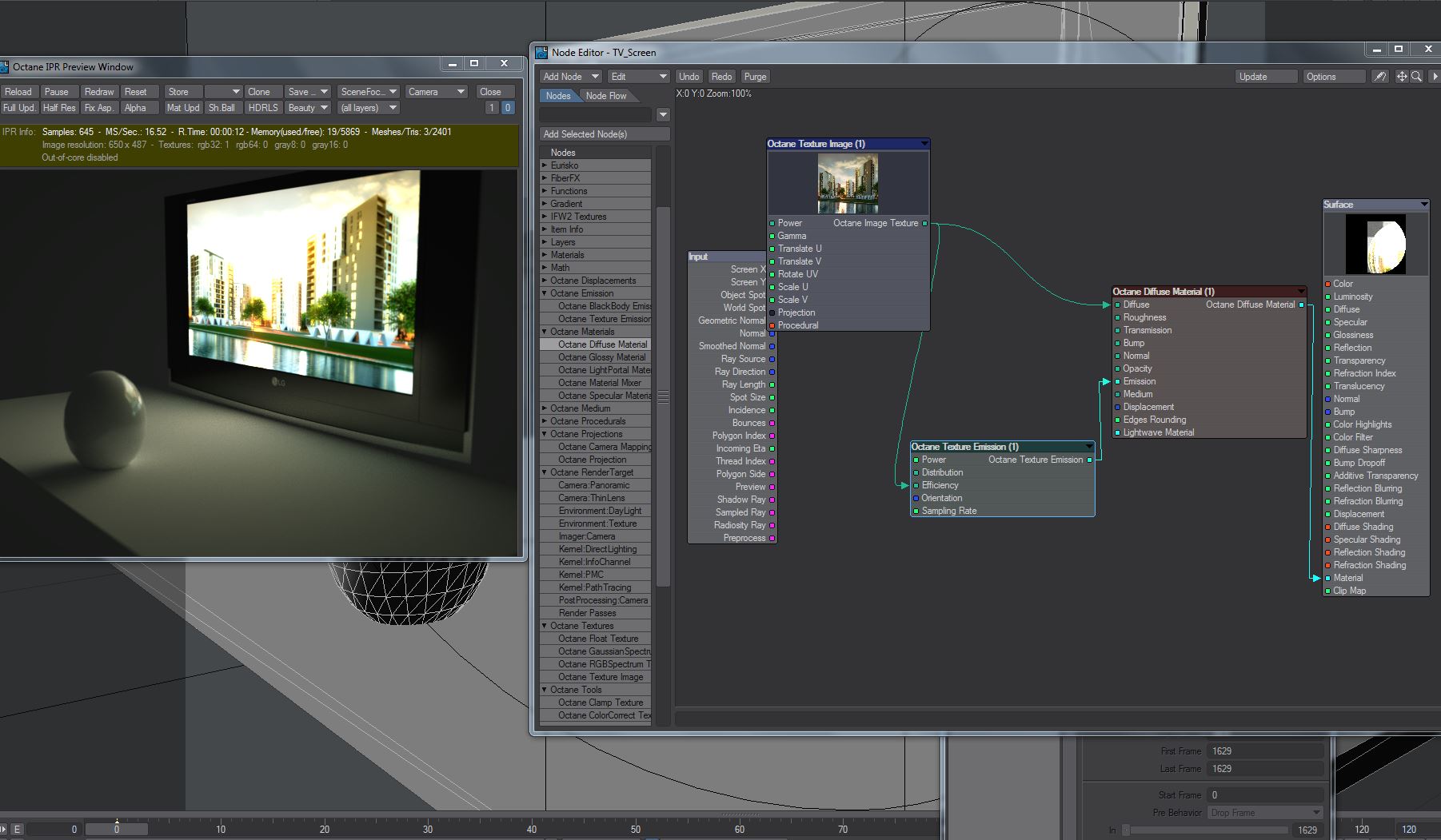

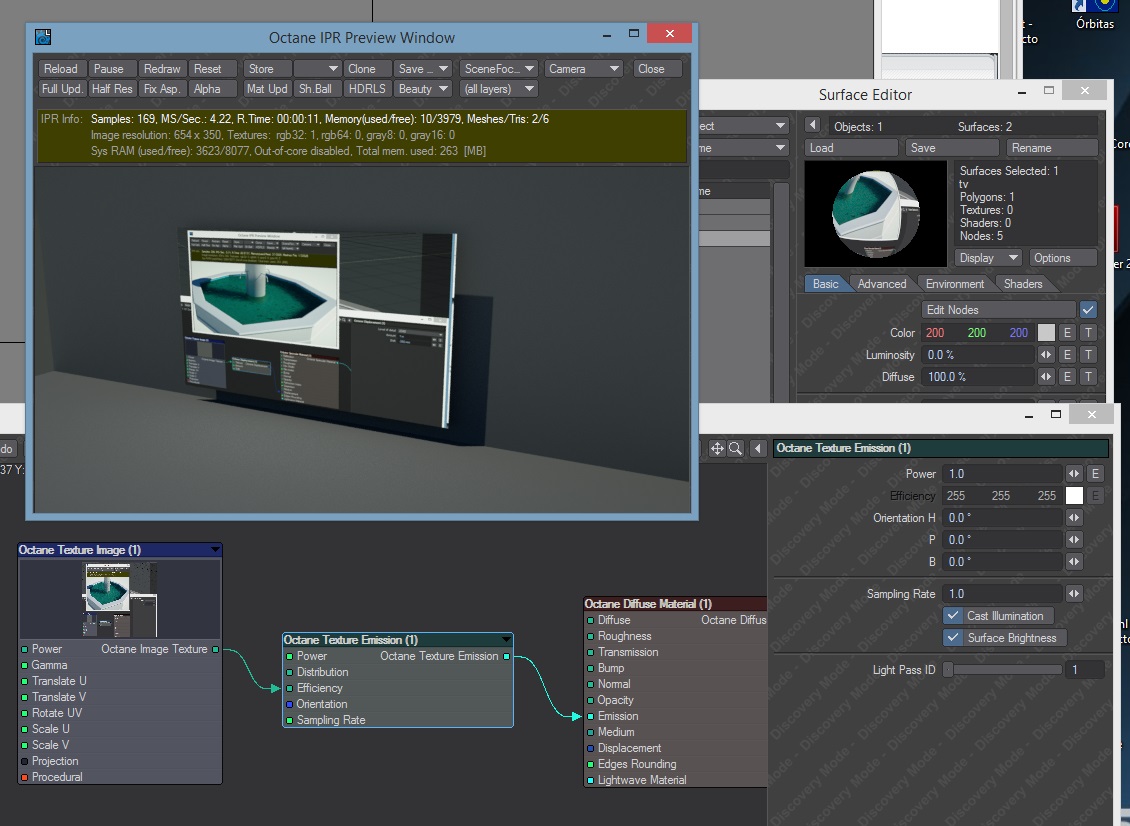

I think that the key is set the diffuse material to black, and enable the "Surface brightness" parameter in the texture emission node. Set power to 1 and you get this image with a default render target.

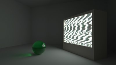

Here's an example of an image as the only light source:

Thank you for the input. Exactly the look I'm wanting to get. Now I know it's possible!
