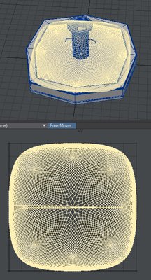

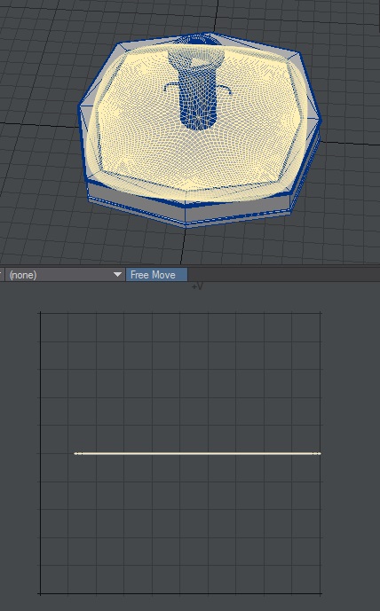

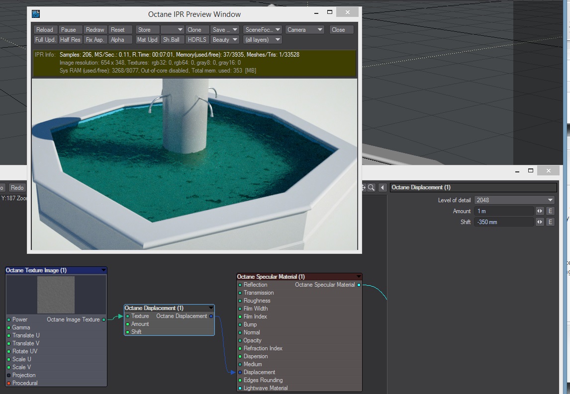

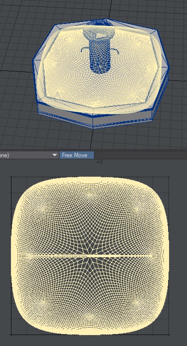

juanjgon
Posts: 8867
Location: Spain
Few tips about displacement in Octane:
- Octane only supports displacement using the object UV map. The projection node doesn't work for the displacement, so you need a proper UV mapped mesh. As you can see in the attached images, the UV available for the water surface is not right for rendering, you need to apply a Y axis planar projection in the modeler first.
- Octane doesn't need a lot of subdivisions in the mesh to render the displacement. Only a quad or a simple triangular circle mesh is enough.
- Displacement is not compatible with any other node. For example you can't use the color correction node between the texture and the displacement nodes. You should use only a simple TextureImage->Displacement->Material nodes tree, like you can see also in the attached image.
-Juanjo
