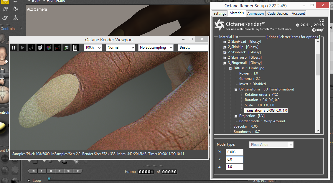

http://imageshack.com/a/img908/1397/nXXdDJ.png
http://imageshack.com/a/img661/4407/B40bhY.png
http://imageshack.com/a/img673/9995/F8iZ6e.png
Pls Pls Pls Pls Pls Pls Pls Pls Pls Pls Pls Pls Pls Pls Pls Pls Pls Pls Pls Pls Pls Pls Pls Pls Pls Pls Pls Pls Pls Pls Pls Pls Pls Pls Pls Pls Pls Pls Pls Pls Pls understand.
face_off
Posts: 15830
Location: Adelaide, Australia
Adjust with the X Transform of the UV Transform of the Diffuse texturemap of the Fingernails material.
Paul
ajr0717
Posts: 59
Joined: Wed Jan 21, 2015 7:44 pm
Does that make both hands work? Offsetting material may offset nail in one direction but the texture map manages both hands and that means an unintentional sliding recession in the other hand.
What I need is an offset+scale combination. Will offset nails to left hand advantage but will STRETCH to accomodate that missing space at the other end of the jpg file that stretches to the other end of the skin map for the right hand. Without doing this and only offsetting will cause parts of the skin map not intended to be shown to be shown on those regions of the fingernails.
face_off
Posts: 15830
You are right - my apologies. Pls see the complete formula here...http://render.otoy.com/manuals/Poser/?page_id=390
Paul
