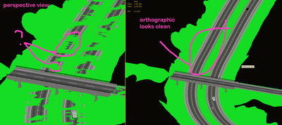

Hi Does anyone have any solution for 3ds max viewport artifacts. Seems like orthographic view is ok but perspective looks strange Happens a lot on large terrains

Correct scale?
Far away from origin?

RobSteady wrote:Correct scale?
Hi Thank you for your reply
scale is correct but we use inches as 3ds max units maybe too small for large terrain
and it is right in the center of the origin

vieport clipping
enable it in the top left viewport menu
a tiny arrow will appear on the right side...it's a cursor
move it up or down.
regards

gabrielefx wrote:vieport clipping
move it up or down.
regards
Thank you! it worked

try to move all to point 0.0.0. x.y.z , viewport clipping work but its not the problem, point 0.0.0 its the problem

also I always try to move rayepsilon a bit up or down, tends to remove artifacts, then scale, or check the world position so it's at 0,0,0
