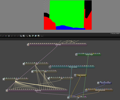

If this would be implemented. Don't do a Black/White Mask, but a RGBA pass. What would be even better.
I already use this by making my own. I make a separate render-Target.
You put your mesh in a Material Map, you link that to 4 shaders (one red, one green, one blue and one black).
Kernel Direct, global illumination Ambient, Environment: Texture environment, with a with texture. Power around 1.1,. (make sure all other lights except the texture environment is off). Camera imager, the response should be linear, exposure 1. Vignettting should be 0
Than you will get this (see image).

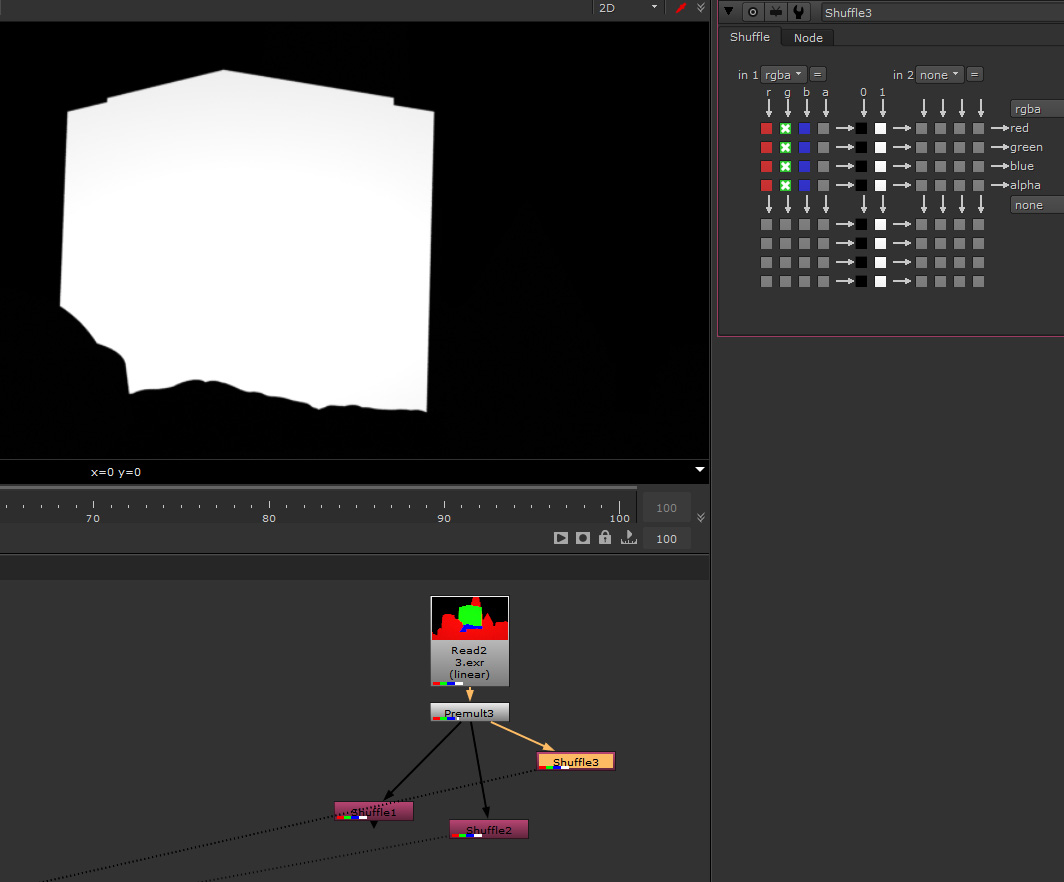

If you then shuffle the channels in you composite program to alpha (for example in nuke) you will get a nice alpha channel.
note: that the value of the color can differ if the exposure and power of the texture environment are different. The values could become greater then one or lens then one.
But, I think your solution is way beter, this is just a work around =).

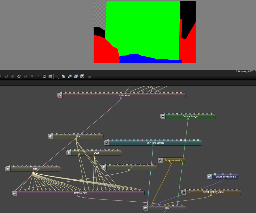

Nice workaround but too complicated, too many extra settings, too time consuming.
A simple ID Channel would do the trick.
