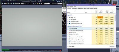

I have tried to use this to do a howie scene as my 770 only has 2GB of vram, I have set it to use about 8GB of memory for textures, I have observed the memory in use by Carrara shoot up at a rate of knots, task manager says nothing is responding but if you leave it it comes back to life, but there is nothing happening in the octane viewer, I know it says using out of core will be slower, but I can believe that it would be a snails pace :p
Is there some special trick to it, or are Howies scene just the straw that will break any card :p

edit: Yip it's the trees, I removed them from the scene and it renders fast in C8.1, I did all you suggested but it didn't seem to help, as you can see from the image.
Edit2: left it while I went and had a shower leaving only the background trees in, seems to be rendering :p - will try a few other things see if I can get all the trees in it
Edit3: On this scene - Countryside seems the fir trees cause issues, I can render with them removed from the scene, with them in I get the issues described, Don't know if that will help
