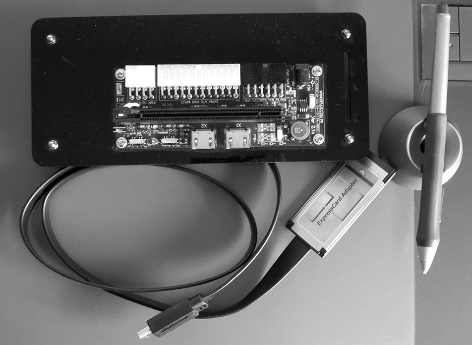

I have this on my table =) will try soon to see how it works - if You're interested I can share some findings.

hehe, I might be there soon (nothing for sure), might give a spin on Your laptop, if I take this kit with me =) still need to order few more wires to be able to hook it from PCIe (in regular PC, & mPCIe in case of laptop). This express card is good only incase if You get Thunderbolt to express card adapter.-rb- wrote:I'm in London at the mo - howdyIssue with Octane Cloud is that I can't see it coming out in the next week! Been waiting about 18 months so far
