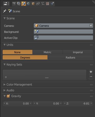

kubicki3d
Posts: 87
Joined: Thu Aug 15, 2013 7:37 am
Location: Bydgoszcz, Poland
Try X-Translation ;)

Ok, I'v got it.
You have to change scene settings to NONE to make it work!

kubicki3d
Posts: 87
I think we can compare the hdri translation to moving UVs in UV image editor. If the environment texture was mapped onto a sphere, and we moved the UVs by 1 x their width, we would see no change - just as if we rotated the sphere by 360 degrees.
If you set units to None in the Scene tab, and translate the environment texture by 0.1, the effect will be as if you rotated the environment by 36 degrees.
If you set units to Metric, the default increment in the Transform node becomes 1m instead of 0.1, which is why it may seem not to work properly - clicking the arrow on the slider "rotates" you by 360 deg. every time.
EDIT: You can drag the X-Translation slider while holding Shift or Alt - this forces smaller increments.

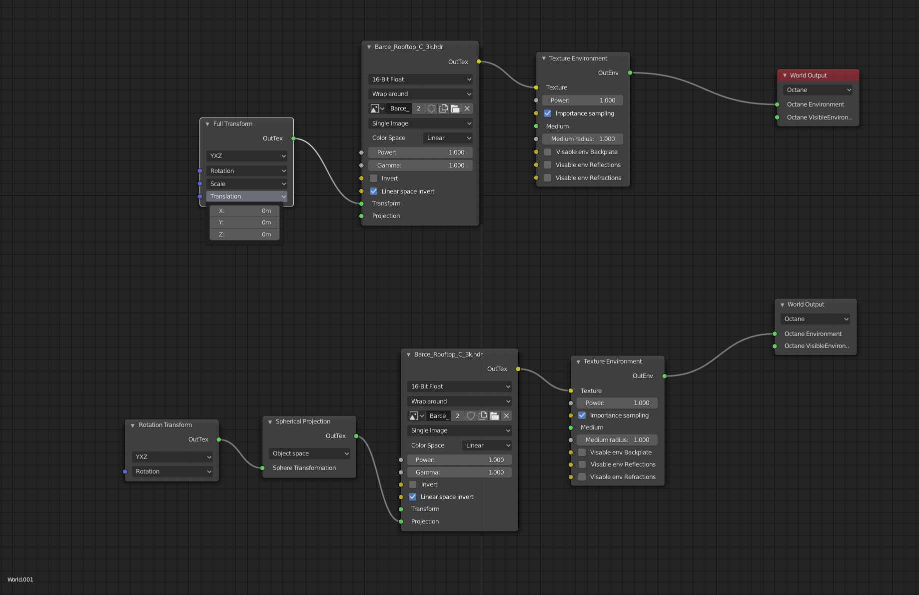

J.C
Posts: 1874
Joined: Thu May 13, 2010 6:35 pm
Location: Wrocław
haffy wrote:I can´t get this to work.
You can do this in two ways:
