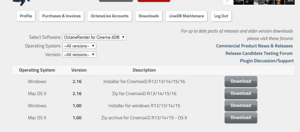

I don't have it in my downloads - only 2.16
That section is for stable releases only. To use the latest versions which are in development stage (unstable but has the latest features) you need to go here:pak wrote:I don't have it in my downloads - only 2.16
http://render.otoy.com/forum/viewforum.php?f=85
Click on the thread with the latest release number (in this case 2.22.1). And then download the plugin from the first post. You also need a matching Octane Standalone. Which since you want to test the latest development version means you will need the latest development version of Standalone. That's here at the top:
http://render.otoy.com/forum/viewforum.php?f=33
