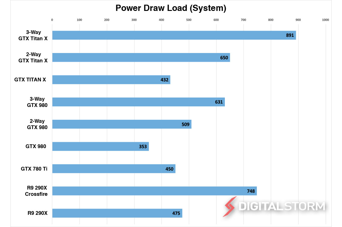

just to back up PSU needs: here's a shot from DigitalStorm tests :

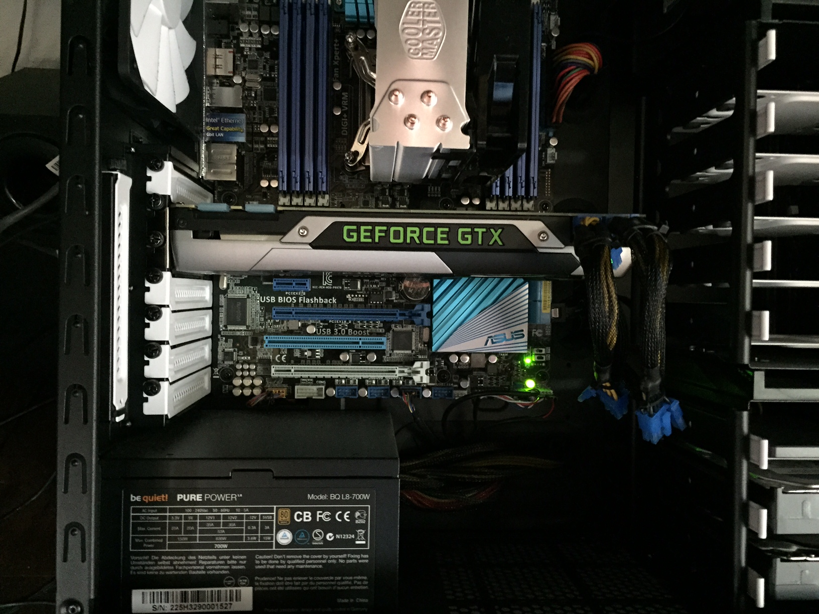

Thanks for your replies, much appreciated. I guess i could keep my PSU and test if its stable, if not order a new one. Its about 1 year old and has been working very hard rendering. I also use Agisoft Photoscan a lot and the processing times on large projects can sometimes be 100 hours or more also doing batch processing. Currently i have a single old style Titan 6GB card. Would it maybe be possible to fit 2x Titan X and 1 x Tian 6GB on my mb? I was guessing not possible so i plan move the 6GB to another computer that needs an upgrade anyway.
I also have this installed in the case. The case is also very well ventilated with huge fan in front and back.

Attaching image. Turns out the PSU is a Be Quiet 700W http://www.bequiet.com/en. Unfortunately the PSU is on the bottom of the case so i guess could be hard to fit 3 Titan cards right?

In Your situation two cards is the best bet =)
case (is that one of Fractal cases?) is a bit too small, pluss motherboard is not good for more than two GPUs - bottom slot is going to operate at way lower speeds & this upload of Your scenes to GPU would be slower =)
if You can get two Xs this should perform 3 times as fast as it runs now =) I think for 2k$ investment - that's a good deal =)
