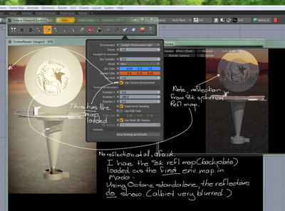

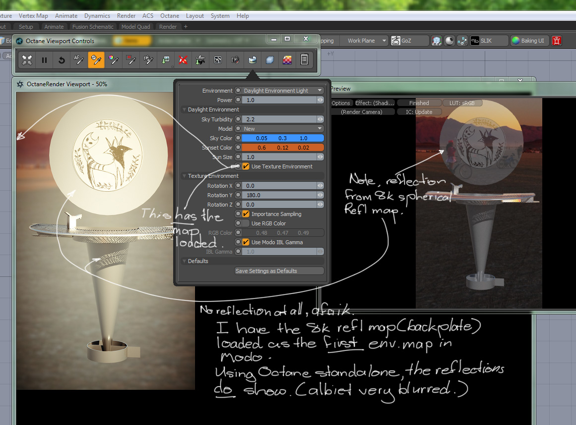

I've setup a scene in modo where there is a "Stainless steel" construction that is catching reflections form the "background".
In Modo it's fine the reflection shows up..
(In the pic its really extreme, but I'm trying to see whats going on, normally it wouldn't be so sharp..)
As can be seen, the render using the plugin seems to have no reflection in the materials at all. Now it may be a fault of the materials, but why does it work in Modo?.

Attached are two pics showing the renders when in modo with the plugin and in the octane standalone. They're not totally the same, I had to muck around with the imager and a few other settings, as I was using a kodachrome setup in the modo plugin and since the plugin follows modo's camera, tried to replicate that without too much mucking around in the SO..
EDIT- I should have said also, in the modo / plugin pic, I have removed the back board to see whats happening with the background hdri.

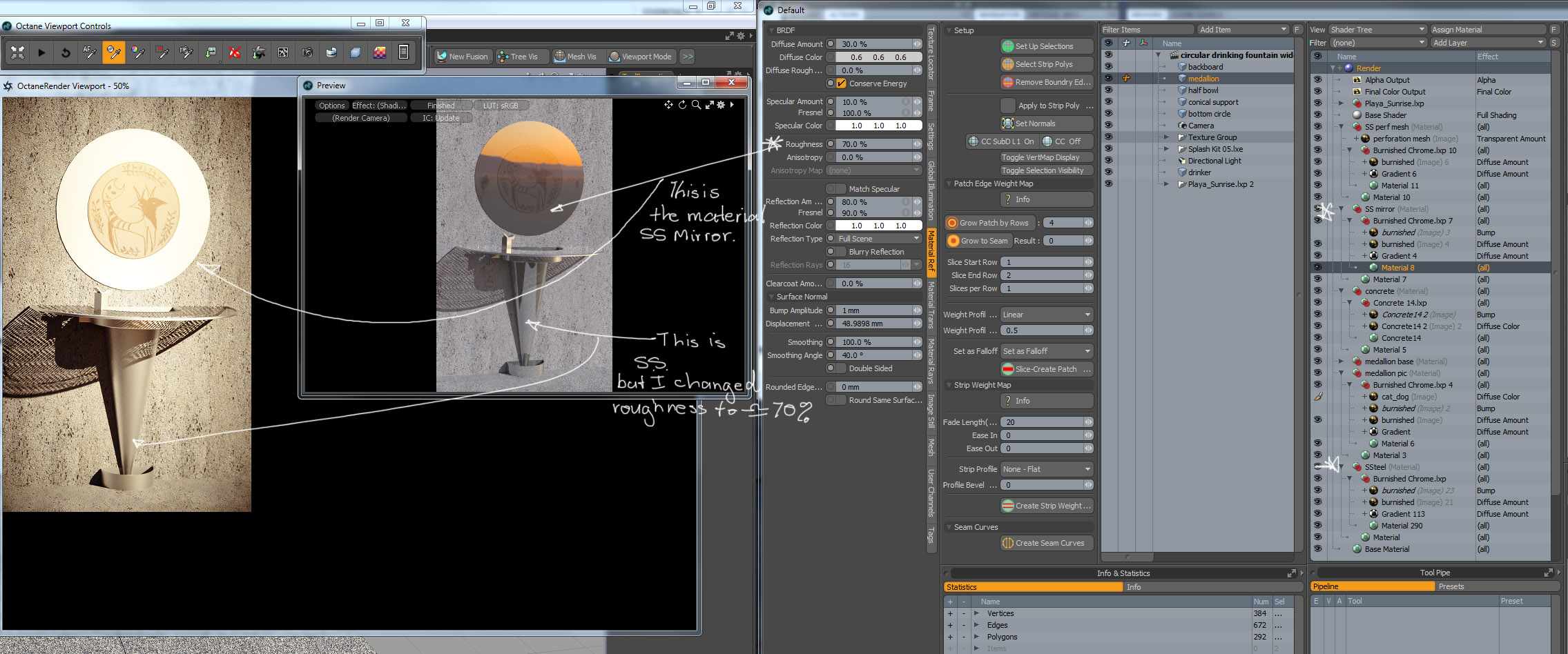

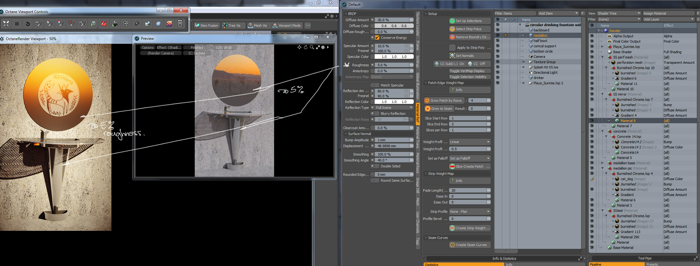

I have had a closer look at this issue and perhaps the way Modo was showing the reflectivity related to roughness, at least in the preview renderer, it threw me a bit.
Looking at roughness in Octane it ranges from 1 to 0.000.. and what I needed to set was around 0.03. The initial modo 70% roughness equated to 0.420 or something around that. ie approximately halfway, so I was a bit confused.
When I think more about it if 1 was 100%, therefore 0.03 is 3%, this is close to what I actually set in Modo of 5% roughness.
Anyway I'll post the pics of the material setup anyway for completeness..
Hopefully you sorta can see that the render in modo does not follow visually the same as the Octane render and that ultimately was what threw me.
EDIT- ps I just had a thought.. often I see on the fourms re modo's decoupled this and that... I just started wondering if the rendering of the materials in the preview do not follow. That is specularity and reflectivity are not coupled...
Using match specular in the material properties produces a much better correlation between reflectivity in modo and octane.
Modo does seem to still modifiy the surface with roughness AND specularity/reflectivity. ie It appears to be a micro surface effect. So reflections go up with increasing spec (as it's increasing the reflection value, but it's certainly more "blurry")
Thanks for your help, certainly I have a better understanding of how things are going now.
