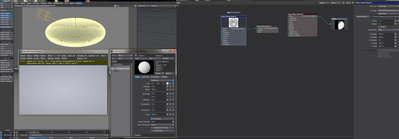

Hi can anyone help me I'm trying to use a displacement on a coin surface, when I try to do this the coin disapears in the ipr has anyone got any ideas what would cause this here is me set up.

Does it have a UV? Is it just that you're displacing it so much that it's moved out of shot?

Thanks for the quick response no it doesnt have a UV has it got to ?

Yes, displacement only works in objects with an UV map. The Octane projection node is not supported, but you can use the UVMAP node to add a custom UV map to the object at render time:
http://render.otoy.com/manuals/Lightwave3D/?page_id=131
