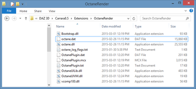

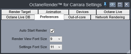

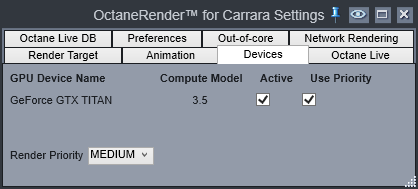

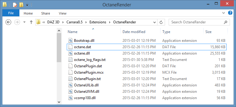

I'm at a loss. Can you open an empty scene? What if you just load a single primitive. If you have a single GPU then go to the devices tab on the Octane Settings dialog and enable priority on your titan and set the priority level to medium. Also in preferences try setting Auto Start Render to true.
I have also included a screen shot of all the files that should be in the Extensions\OctaneRender directory. Can you confirm their dates and file sizes...

Resolved. Culprit is indeed ----> default Auto Start Render = false.
From Scene> Effects> OctaneRenderTarget> Edit> Preference, I set Auto Start Render = true. No more crashes. And I haven't even turned on 'use priority' yet. Everything then renders flying fast out of the box.
For good practice... I should enable my single Titan's use priority anyway, and keep level to medium, correct?

Also, yes all 10 files exist in OR4C (2.17) Extensions folder. The 27/2/2015 files have the same size as yours.

Glad you sorted it out. As far as device priority, the Titan is a pretty powerful card and it is all a matter of how responsive you want the UI to be. If you want to do a lot of interactive work while the viewport is open then pick medium or low. It is really a preference thing.
