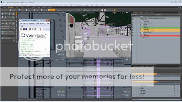

I'm having a very strange issue with some material not been seen by the material picker and not rendered in one scene, but when I copy the geometry and paste It in a new scene , everything works as It's supposed to.
Here is a video:
http://vid1205.photobucket.com/albums/b ... a3q879.mp4
Material not seen

Hi - I can't be sure from watching the video, but I think you either have that material group as a Selection Set (which is not supported by the plugin), or you have a nested Shader Tree groups with item or polygon tags. Check the Modo Event Log for any errors. And can you post a screenshot of the Texture Layer of the two nested groups for that material pls?

Ok, thank you! I exported the project as a lwo file and re-imported It and all the sub-folders are gone (lots of surfaces, that was quicker), this fixed the problem.
Thank you for your help.
