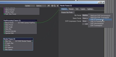

How can i save the render-passes in seprarate files?
The layered EXR-File are in PS black :(
On IPR i can all passes see, but when finish nothing...

You can export the render passes as separate files if you select the PNG or EXR file formats in the pass node.
-Juanjo
But i choosed more than this one.
Shouldn't be there for every render-passes one file?
Solved... Thank you.

Photoshop doesn't do multi-layer EXR out of the box. You need the ProEXR plugin to view them.
