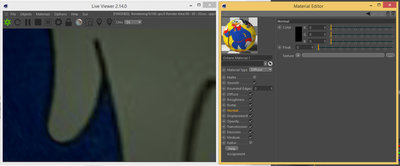

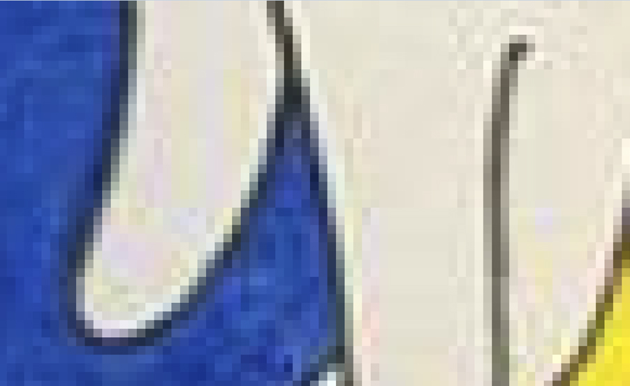

i am experimenting with some simple texture
screen of the windows picture viewer
as you can see i just have a simple img in the diffuse channel. but when i zoom-in i have the anti aliasing that makes my image looks blurried.
instead when i zoom-in i would like to see my pixels nice and clear like in the windows picture viewer.
is there an option to achieve this effect? thx!!
(i have just noticed that if i want to achieve this effect with standard c4d material i have to put the sampling to none in the texture tab)

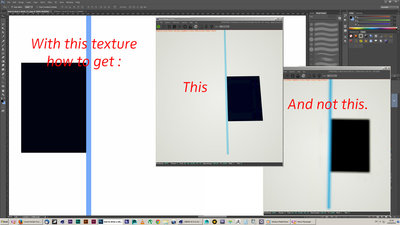

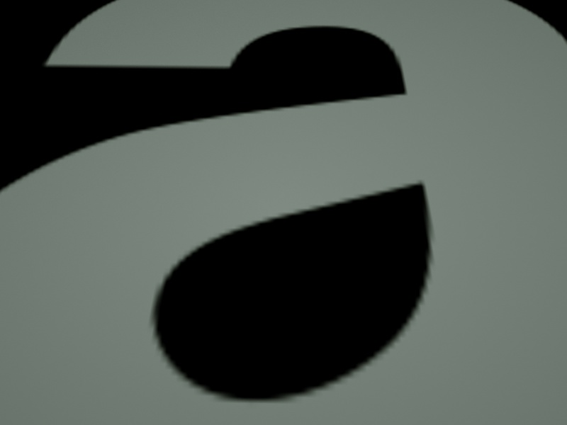

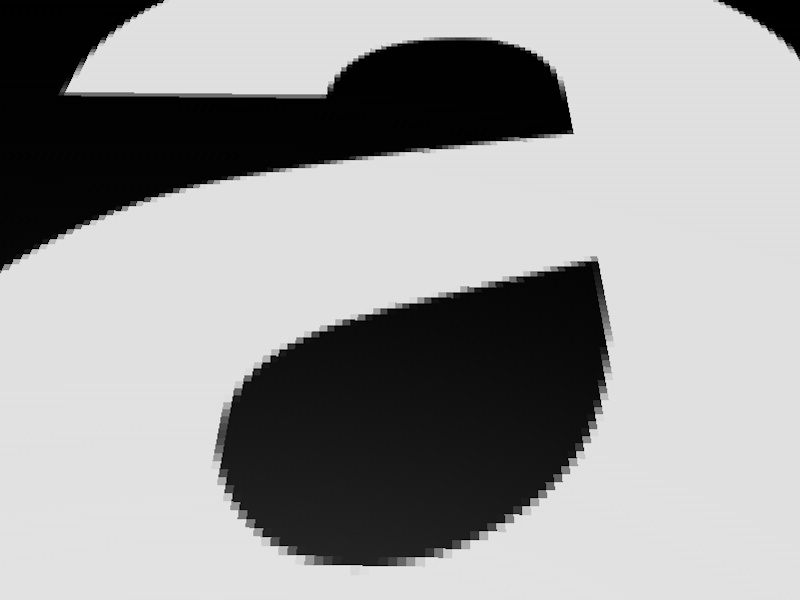

you misunderstood i am not talking about the artifacts
look the borders
this is what i want to achieve
and this is what octane gives me
tomabobu
Posts: 71
Joined: Tue May 20, 2014 5:38 pm
The question is if there is a way to control the aliasing of the textures.
(the blue line is 1 px in width)

This effect is easy to create with a resampling in Photoshop in Image size > Resample image: > Nearest Neighbor (Preserve hard edges). Or with the Filter > Pixelate > Mosaic if you dont want to resample.
By resampling your picture, you'll add more pixels and you'll have more control on the result. Adding a Mosaic effect on a low definition picture will not give the same control.
