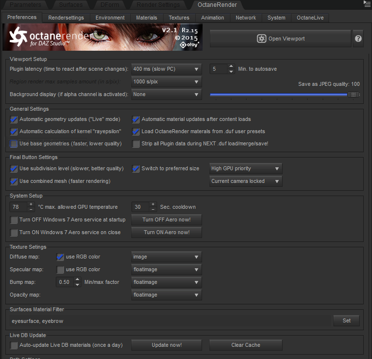

Running through the basics in my head (I apologize if you have already done all of this before):
1. Is OcDS set to auto-convert? There's an option in the preferences panel to do so, and there's a toggle, if you've added the tools to your toolbar.
2. If you've already gone through the other setup steps, I really can't think of anything off the top of my head aside from this that should be stopping you.
Should look something like this:
And the toggle looks like this (clicking it cycles through manual loading only, from the .duf-saved Octane mats, and automatic conversion with .duf-saved mats taking priority):
It is currently set to "Auto," reflecting the preferences setting.
I guess check this first, and make sure it matches up. If that doesn't help, we'll go from there.
