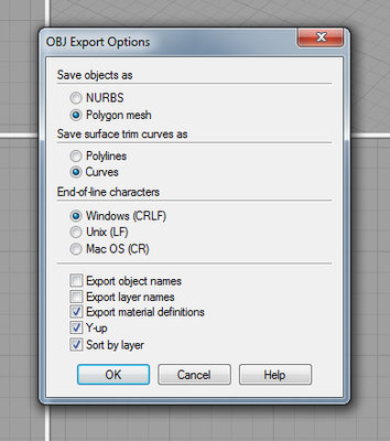

As for the crashing on Rhino v4, can you take a screen grab of your obj export settings? There may be a misapplied setting that we can correct.
Sam
Win 7 64bit | 2x GTX 285 | i7 920 | ASUS P6T Deluxe | 12GB
watanabe
Posts: 20
Joined: Sat Aug 07, 2010 12:03 pm
Hi Sam,

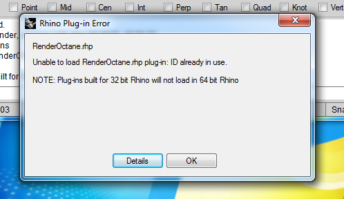

Below are the 2 errors I get. There is no version of RenderOctane installed in the 64bit version.
Also the 32bit v4 error is not really an issue, most of what I do is in 64bit as I run out of RAM in 32
rhino v4 32bit export settings
rhino v5 64bit error

OK, thanks, checking on these. What version of Octane are you running? Do you still see the crash exporting from V4 using Octane pre-Beta 2.3 v5?
