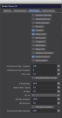

Do you have a recommendation for typical mulitpass Max settings for Zdepth and Motion Max speed? I'm rendering Zdepth and motion vectors. The depth is working great, but my motion vectors are coming in plain white. Also, do you think 10 is too high for Zdepth Max? I want to be efficient. It seems good according to my test render. The motion vector as I said is pure white, so I won't post that. Here my dialogue box attached...

The motion vector pass is only visible as image if your objects have large motions ... it is a very faint effect in an image, but it's floating buffer works if used in the post software.
