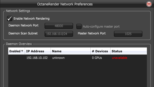

Problems connecting to a remote computer in integration version.
Plugin for C4d(2.21.1) (problem)
Standalone (no problem)

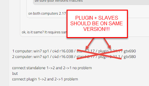

be sure your versions matches
Proff54
Posts: 9
Joined: Wed Sep 21, 2011 8:37 am
aoktar wrote:be sure your versions matches
on both computers 2.17 - standalone and 2.21.1 - plugin
I7 3930K 6 Core+HT 3,3 Ghz / 64 GB Ram / GTX690 for Octane / Quadro4000 for display / Win 7 64 Bit
Posts: 16067
Location: Türkiye
ok, is it same? It requires same for all
Proff54
Posts: 9
aoktar wrote:
1 computer: win7 sp1 / c4d r16.038 / stand 2.17 / plugin 2.21.1 / gtx690
2 computer: win7 sp1 / c4d r16.038 / stand 2.17 / plugin 2.21.1 / gtx580
connect standalone 1->2 and 2->1 no problem
but
connect plugin 1->2 and 2->1 problem
Posts: 16067
Location: Türkiye
see picture
Proff54
Posts: 9
aoktar wrote:see picture
Thank U.
