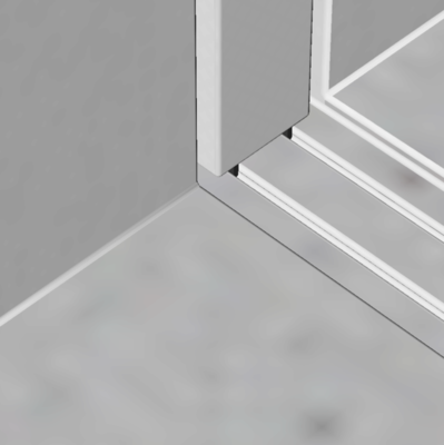

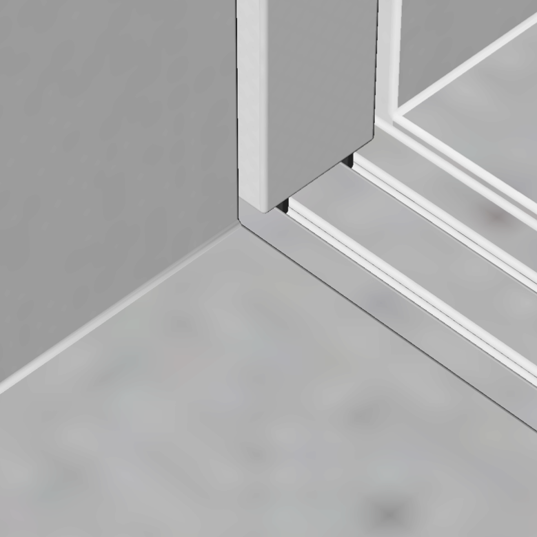

I've box modelled an interior which I have applied a Bevel Deformer to. I've applied different textures to different polygon selections and thrown a basic "white" material on top of all the model. Making everything that not has a polygon selection recieving that "white" basic material.
Now here comes the question - the new faces created by the Bevel Deformer - they get that white basic material. But I don't want that. How do I solve this without making my model with deformer editable? I want to keep the deformer on.
See all the white edges? Same as the wall material. I like it on the bottom of walls - but not in the concrete floor.

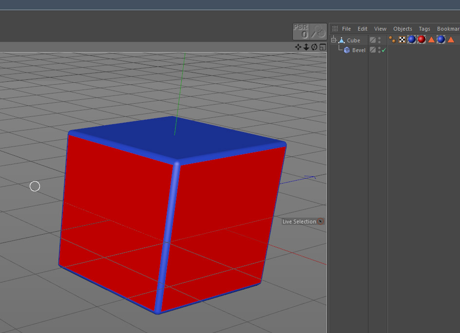

Separate the objects based on materials. Have an object for the wall and a separate object for the floor. In this way you will assign the material without a selection tag and all the new faces created by the bevel deformer will get the same material.
Cinema4D R17 / Windows 7 on Intel i7-3930K / 32 GB Ram / GTX 670 / GTX 780 / 3 x GTX 970 on Amfeltech expansion cluster

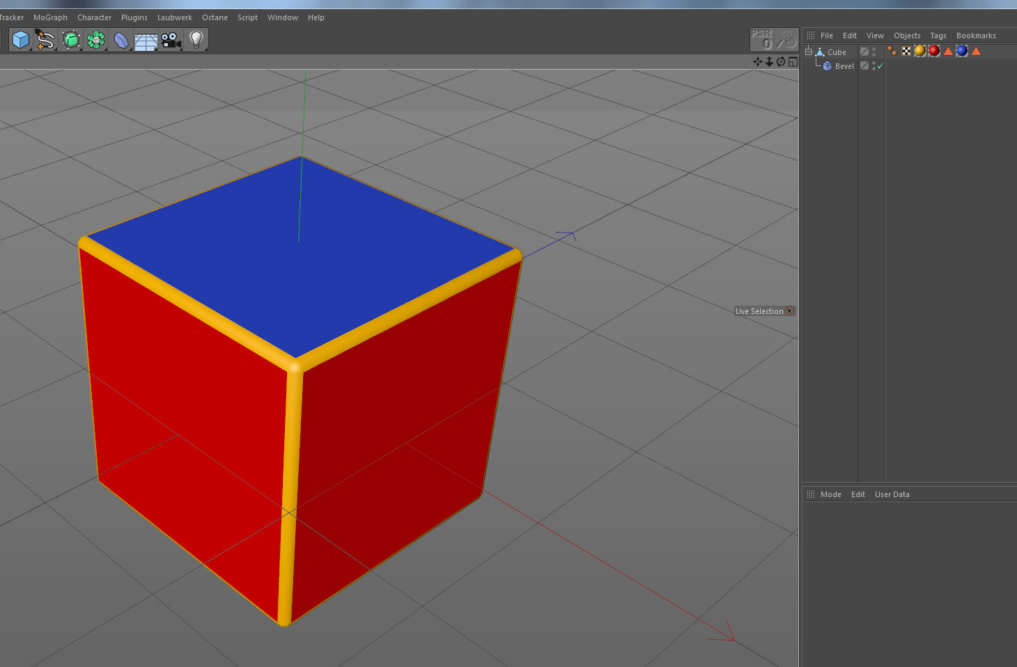

hope it helps. the yellow is the base. no selected poly.

Thanks! But isn't this exactly my problem? =)sadece wrote:hope it helps. the yellow is the base. no selected poly.
Your yellow is my white base material. Same problem?

sorry. couldn't get what your point ismartincarlson wrote: Thanks! But isn't this exactly my problem? =)
sorry i'm not clear with your question yet:)

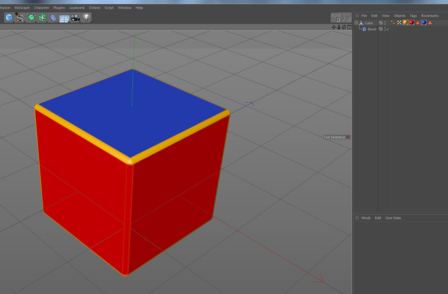

Ok - see my retouched version of your example. If I want to achieve this? Yellow is still base material.sadece wrote:sorry. couldn't get what your point ismartincarlson wrote: Thanks! But isn't this exactly my problem? =)
Your yellow is my white base material. Same problem?if i want the edges blue than replace onto yellow and same with red. but maybe you're asking to control each! bevels seperatly? i think this ain't possible.

yes=) not possible within deformer. but only way "current state to object" sorry for the confusion that i made=)
