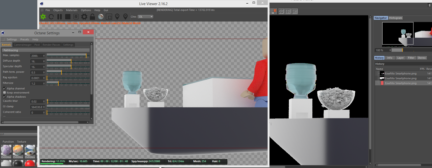

Hello there,first post here. New to Octane obviously. I need some help to understand why do I have so much aliasing in the final render and not in the LV. Could you please point me to the right direction of what i might be doing wrong???

have you checked the saved images? If you do, you'll see that everythings is fine. It's just a presentation problem of alphas. Without alpha multiply, Octane's latest versions will not apply any filtering on borders of alphas. You can use "alpha multiply" or not, but i don't select. It's depend to your work.

Aoktar thank you for the immediate reply. You are right about the result,it's flawless! I want to thank you personally for the hard work and for replying so fast! Keep it that way and you will have very happy customers! Cheers!
