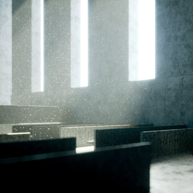

Here's one of my godsray test. Also with dust particles.
I used the fogbox with the camera-bubble technique.

Depending on the scene and on what kind of volumetric lights you need, you can also create a copy of your scene and use the good old AR3
to render stunning fast volumetrics passes.
Then in post, using after effects i.e. you also have great control over the volumetric light renderpass.
