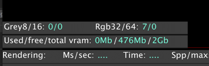

I have try it with several scenes and reduce them more and more
Can i tweak some settings to get bigger scene rendered
Or is my GTX 680 to small
example vram
example vram
project settings
project settings
Bildschirmfoto 2015-02-25 um 11.45.02.png (13.24 KiB) Viewed 9963 times
Mac 10.9.5 | Geforce GTX680 | 2x2.66 6C Xeon | 32GB

What does your Used/free/total VRAM say when you are rendering just a cube? If your free when rendering a trivial scene is low, then double check you don't have any other software running that is using your VRAM. Close everything else and restart C4D and octane.
The OS and other software will use up VRAM, leaving less free for octane. If you are rendering on the same GPU that your monitors are plugged into then you will never have the full amount of VRAM available to octane, but with windows, you should be able minimize the OS's usage to something like 300MB, leaving about 1700MB free for your octane scene.
4mil triangles should take up about 600MB (geometry only) so I would expect this to fit ok. Do you have some huge textures or very high render resolution?
