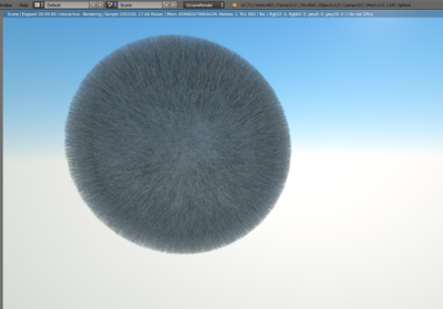

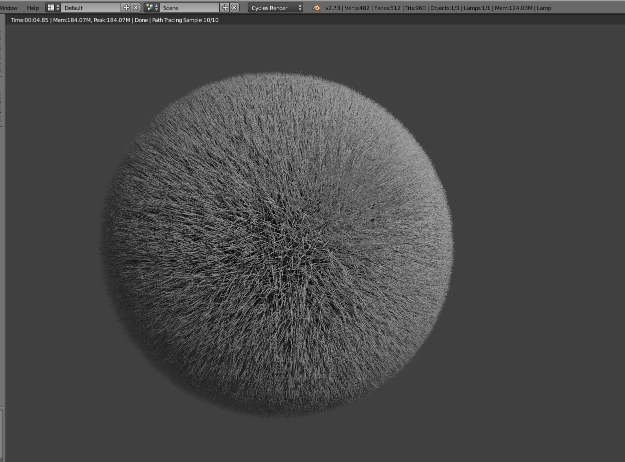

Hi mib, thank you for your reply.
The project is not mine alone so I'm afraid I can't send it. But hair that looks fluffy in the Cycles version kind of 'melt' together in rubber-like blobs in Octane. And it takes longer to render in Octane (and I did check GPU twice in Blender.)...
As for speed - here are two renders of another file, one in Cycles and one in Octane:
[Cycles, above = 4.85 sec. Octane, below = 9.80 sec.]

OK, here's why my Cycles hair projects looked so bad in Octane:
Hair tips were not set to zero for several hair systems - and I didn't use Path Tracing. I don't prefer it for most purposes, but it's fantastic on hair.
Octane hair rendering is still slow on my system, compared to Cycles, but Path Tracing definitely makes it worth while!
