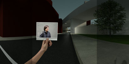

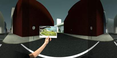

Trying to get octane renders into VR environments. Currently throwing arrows in the dark since I don't have vr goggles yet, at first glance the "Eye Distance" look like it's more than .065. Anyone with goggles?

r-username wrote:Trying to get octane renders into VR environments. Currently throwing arrows in the dark since I don't have vr goggles yet, at first glance the "Eye Distance" look like it's more than .065. Anyone with goggles?
http://www.profileme.com/pano/stereo/index.html
Pano camera, stereoscopic Left/Right Renders. .065 IPD
For correct rendering you need http://mozvr.com/downloads/ or Chromium WebVR Builds but it works in any html5 browser.
http://www.profileme.com/pano/mono/index.html
Just the pano camera and a html5 browser
In your rendering your scene is imported way too small and with that the eye distance is way too big for your scene. Fix the scene scale and it should be alright.

r-username
Posts: 217
Joined: Thu Nov 24, 2011 3:39 pm
updated
http://gigavr.com/pano/subway-01/index.html
ipd 0.065
thanks for the response, you were correct the model was the wrong scale.
