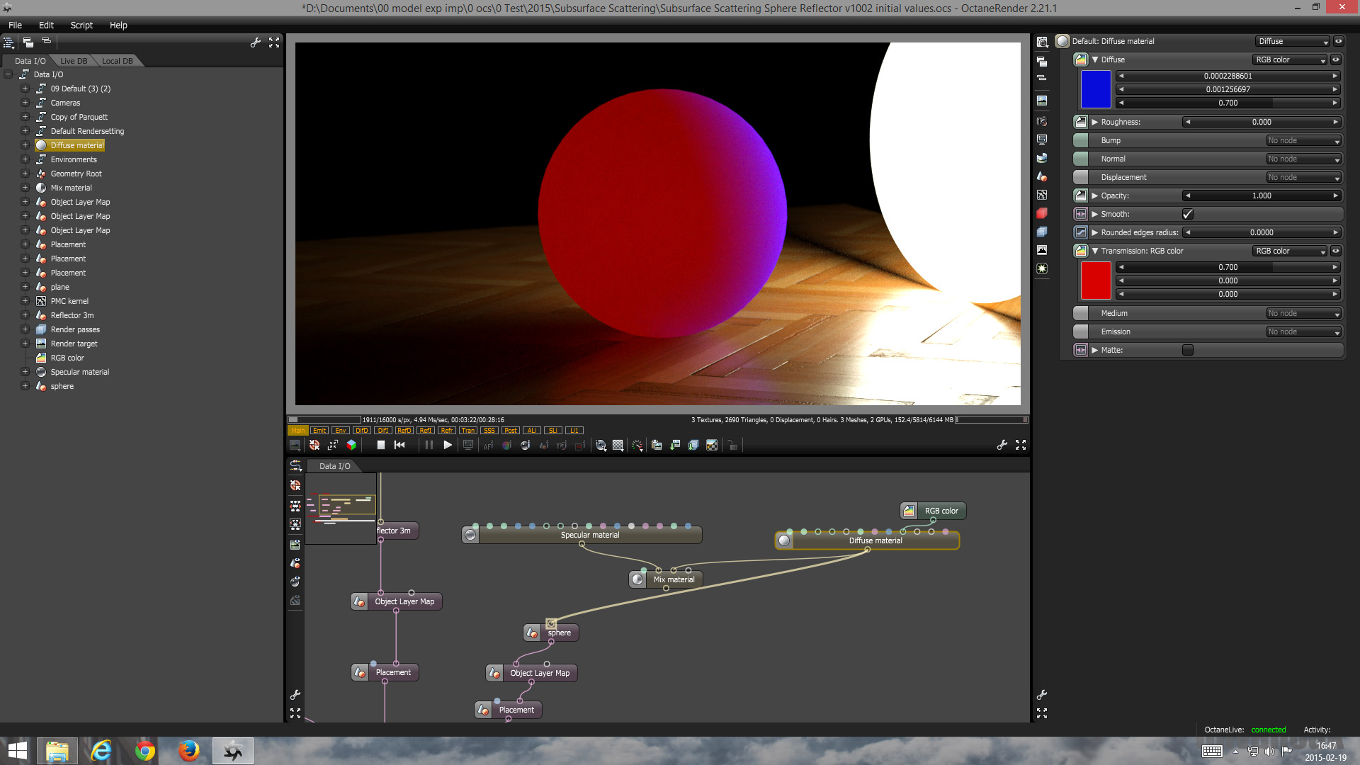

If you take a Diffuse material with Transmission you get:
Diffuse Material with Transmission - Beauty Pass
As I would expect the transmission is output in the Transmission pass:
Diffuse Material with Transmission - Transmission Pass

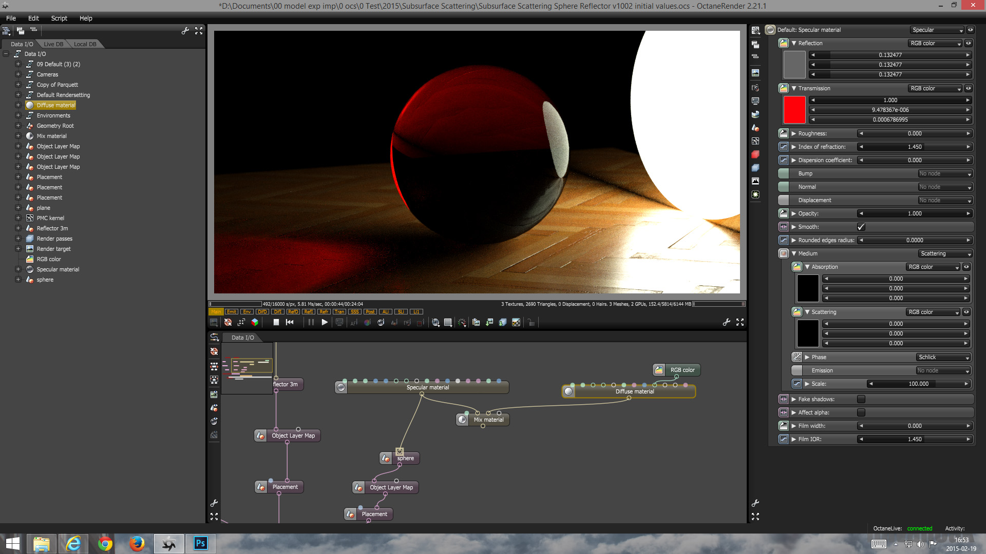

But when you create a Specular Material with Transmission things seem to be different:
Specular Material with Transmission - Beauty Pass
Now the Transmission is output in the Refraction Pass?!
Specular Material with Transmission - Refraction Pass

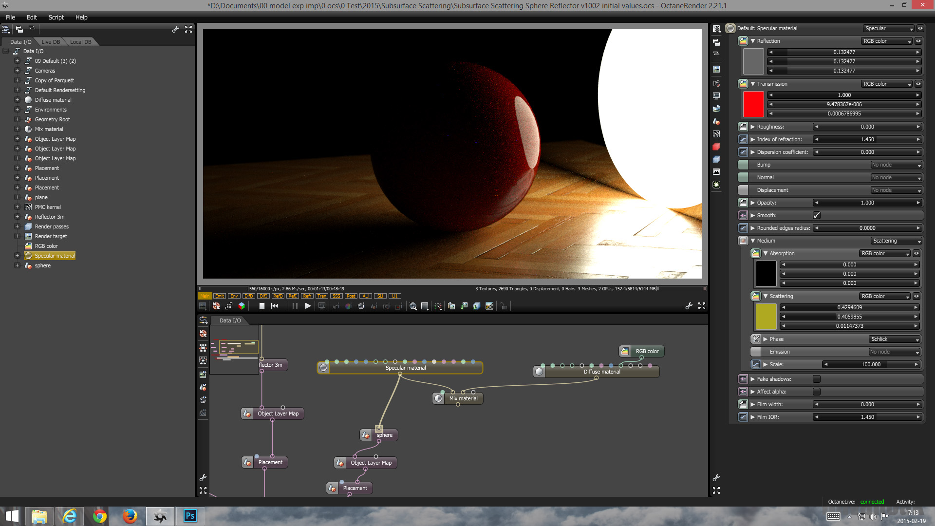

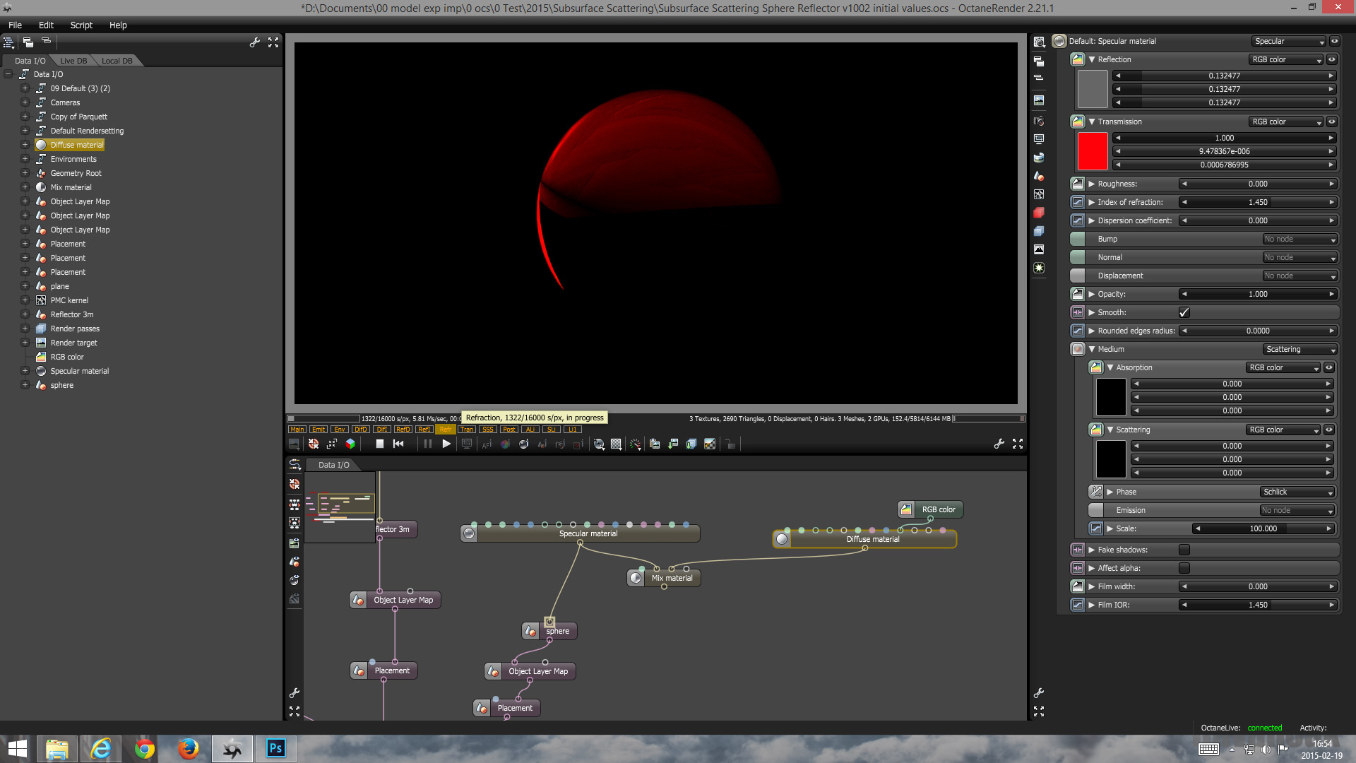

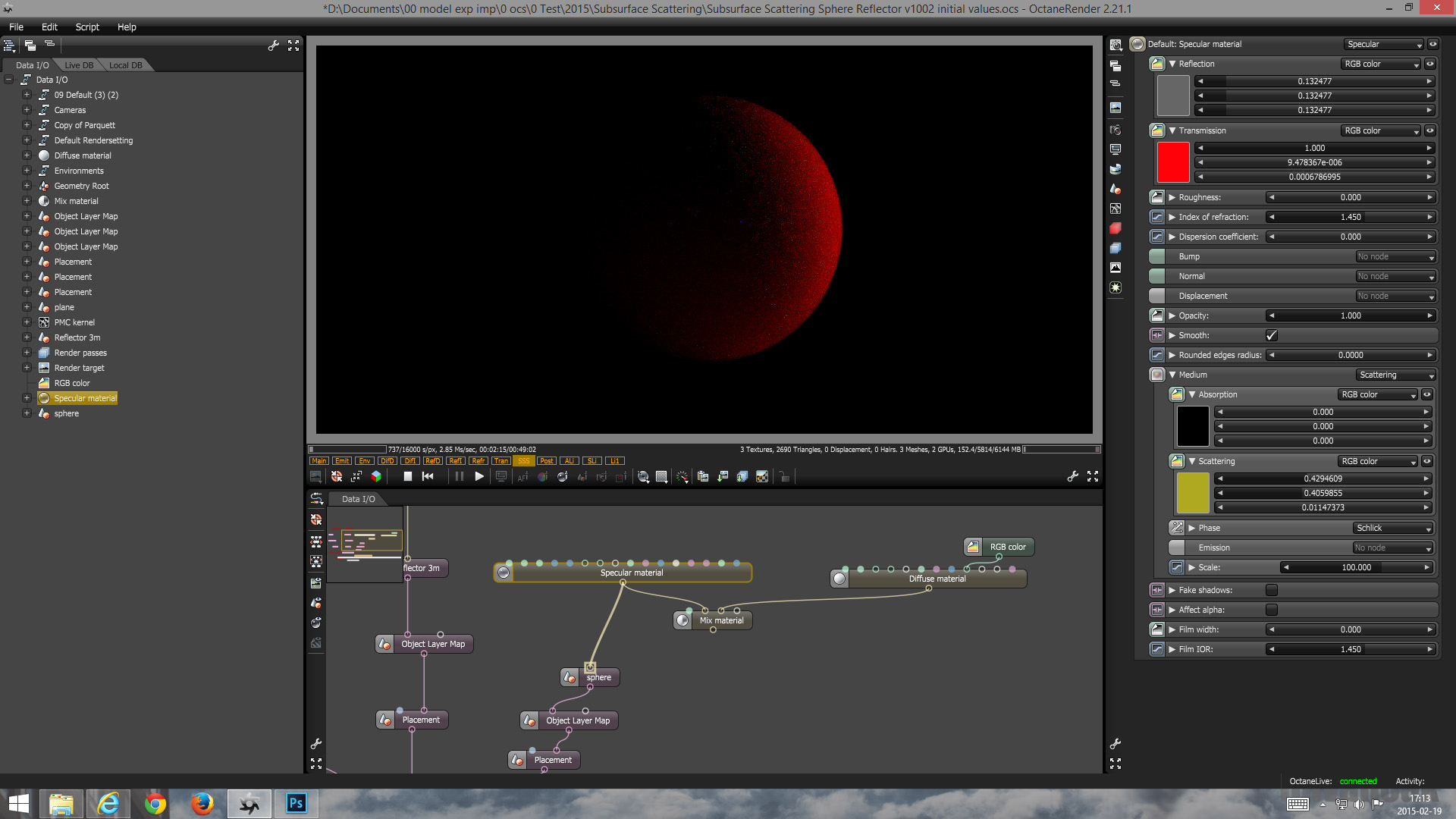

Now I add some Scattering to the previous Specular Material.
A Specular Material with Transmission and Scattering:
Specular Material with Scattering - Beauty Pass
But now there is nothing to be found anymore in the Refraction Pass.
The result is now displayed in the SSS Pass:
Specular Material with Scattering - SSS Pass

I will try my best to explain. Refraction, transmission and SSS are tightly coupled and it's easy to get confused.
Refraction: Applies only for specular materials. In a sense it's like the diffuse transmission but rays go in a pre-defined direction. The rays are refracted at the interface between the 2 materials because the speed of light is different in the materials. For more info refer to Snell's law which gives the relation between the incoming and refracted ray.
For refraction, the direction of the ray changes when it enters another material.
Transmission: Applies only for diffuse materials, light rays are refracted according a cosine distribution on the hemisphere. Mathematically this means that the ray can make any direction with the normal between 0 and 90 degrees but smaller angles are more likely (because of the cosine distribution). (NOTE: I initially confused this with opacity but it isn't the same. For opacity the rays go straight through the medium while in the transmission case they are still refracted at the interface). This is the same effect as translucency in nature.
Translucency like in diffuse transmission.
SSS: Subsurface scattering means that the light ray is scattered under the surface (i.e. in a volume). To put it simple, a light ray travelling in a medium can all of the sudden decide that it doesn't like it's current direction any more and change direction. This is called a scatter event. In Octane you can control the different directions that a ray can scatter via the phase (i.e. can the ray reverse totally backwards or can it only deflect it's direction a bit?). The further a ray travelled in a medium, the more likely it is to scatter. This scatter probability is controlled via the scale pin on the medium. If the medium is thick enough, all the rays will scatter and none go through the medium.
Transmission and refraction are a necessary precondition for scattering. The ray has to enter the medium before it can scatter. If the ray enters the medium, it doesn't necessarily mean it will scatter. Rays that go all the way through are normal transmitted/refracted rays and will go to the corresponding render pass. Rays that where transmitted/refracted at the interface but then scattered in the medium will go to the SSS pass.
In your scene, all the rays are scattered in your sphere because the sphere is too thick or the scattering probability too high. Non of the poor rays makes it to the other side without being scattered and hence you don't see anything in the refraction pass. Try playing with the scale on the scatter node or use thinner geometry that way you should see something in both the SSS and refraction/transmission passes.
