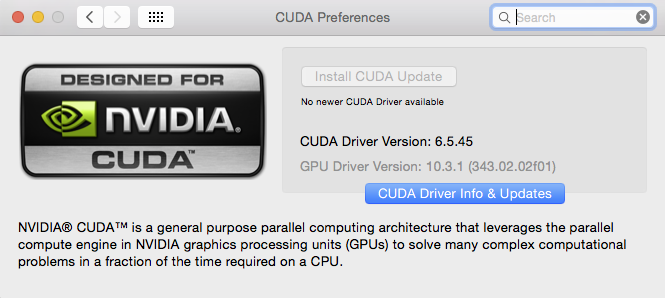

On Mac OS X, where can I find the octane logs?
I keep getting an error warning when trying to start up Octane in MODO.
Both licences are active so I am kind of stumped as to whats going on.
I've also attached a screenshot of my CUDA driver version.
Any suggestions would be great.

Started logging on 17.02.15 08:57:20
OctaneRender version 2.16 (2160000)
CUDA error 300 on device 0: The device kernel source was invalid.
-> failed to bind device to current thread
device 0: failed to initialize resources
Do you know what Error 300 could mean?

Running a GTX 970 unflashed in a mac.
Deactivated and reactivated the licences.
Rebooted.
Standalone is not working either. Its saying Graphics Card failed.
I might try an older version of cuda. See if it makes a difference.

Solved.
There was another NVidia driver for newer maxwell based Cards (6.5.46). It wasn't coming up in the system preferences for some reason.
