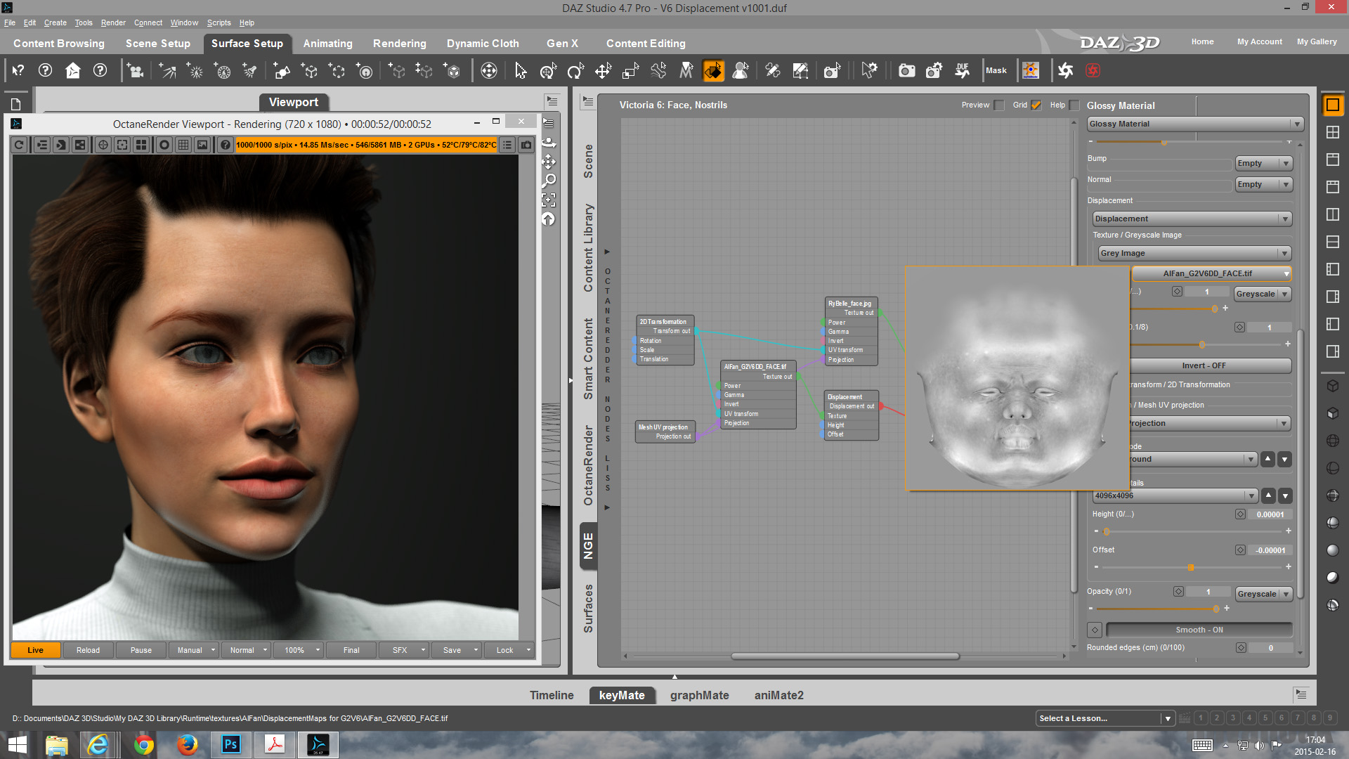

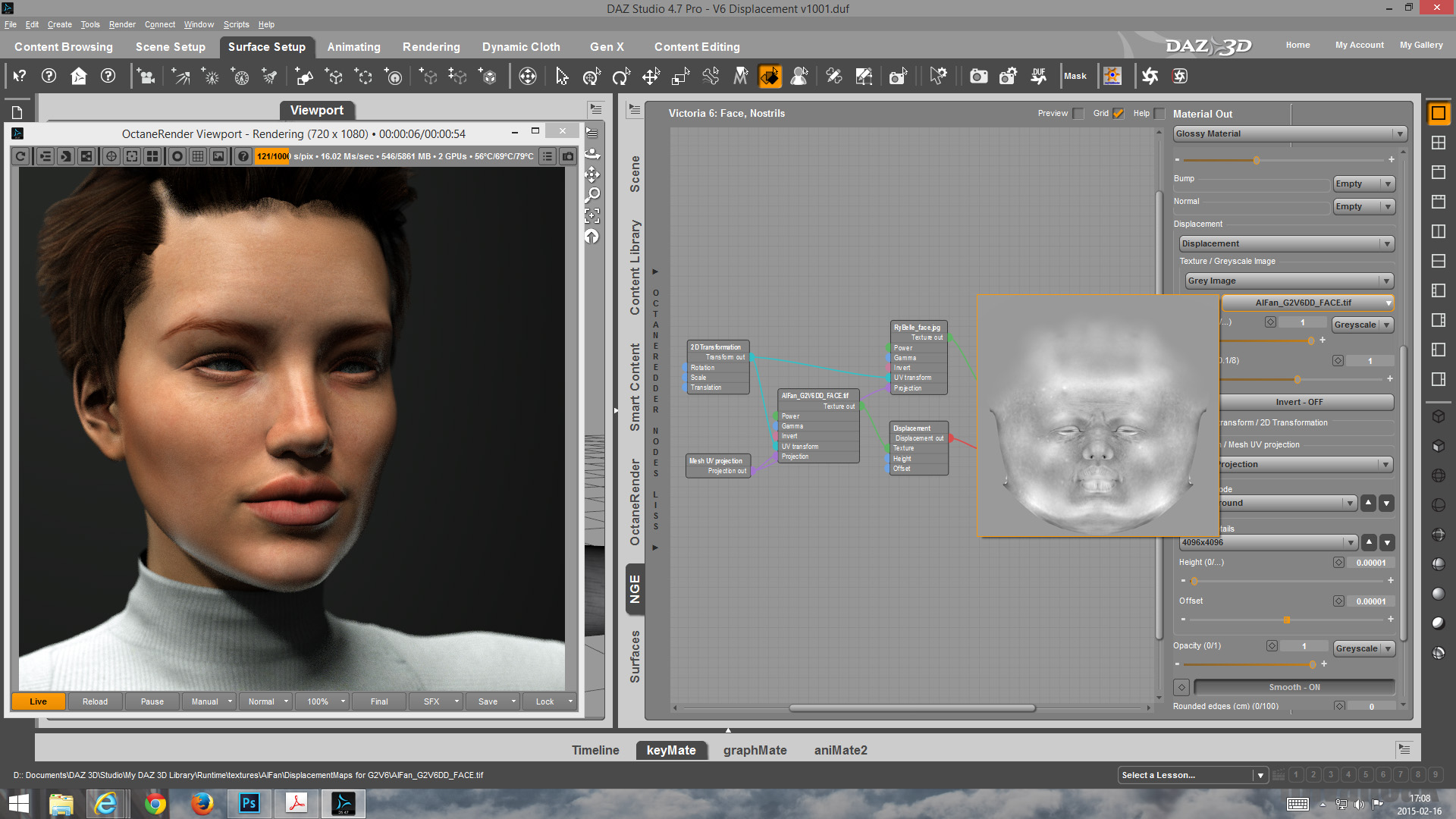

I tried to experiment with these maps but am currently not very happy with the result.
Maybe the issue is that the maps were designed with 3Delight in mind.
Therefore it is quite difficult to figure out which "Height" and "Offset" combinations to use.
I tried with very small values:
Height 0.00001
Offset -0.00001
Issue: Displacement not strong enough
Issue: Whole Head geometry is enlarged.
Issue: Whole Head geometry is enlarged even further.

As you can see those very small changes have a huge effect on the result.
Maybe what we would need are different kind of displacement maps that have the neutral point at black and not at mid grey?

The offset value needs to be half the amount of the height value, but in negative
Meaning, if you have amount = 0.01, then Offset = -0.0005.
Try it with that.
Displacement on characters otherwise is very tricky, since the displacement will usually clip through conforming clothing (or hair as in your example).

Awesome! Thank you so much for clarifying this!TRRazor wrote:The offset value needs to be half the amount of the height value, but in negative
Try it with that.
You can also check out this thread in the forums to find out a little bit more about it. since another user already had the same issues.: http://render.otoy.com/forum/viewtopic. ... nt#p211140
Cheers
Noel
I read about the "offset half of the height value" rule before but completly overlooked the "in negative" part!
