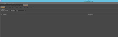

I have swichted my octane account onto my notebook and just simply octane won't see my M880 which is also cuda...
Any topics regarding this issue?

Sometimes when my laptop is on battery it wont recognize the 880 as it is running on the intel graphics, on which octane will not work. This also seems to randomly occur when I plug my laptop in, it still uses the battery optimization limiting the CPU to 1 ghz and using the intel graphics.
