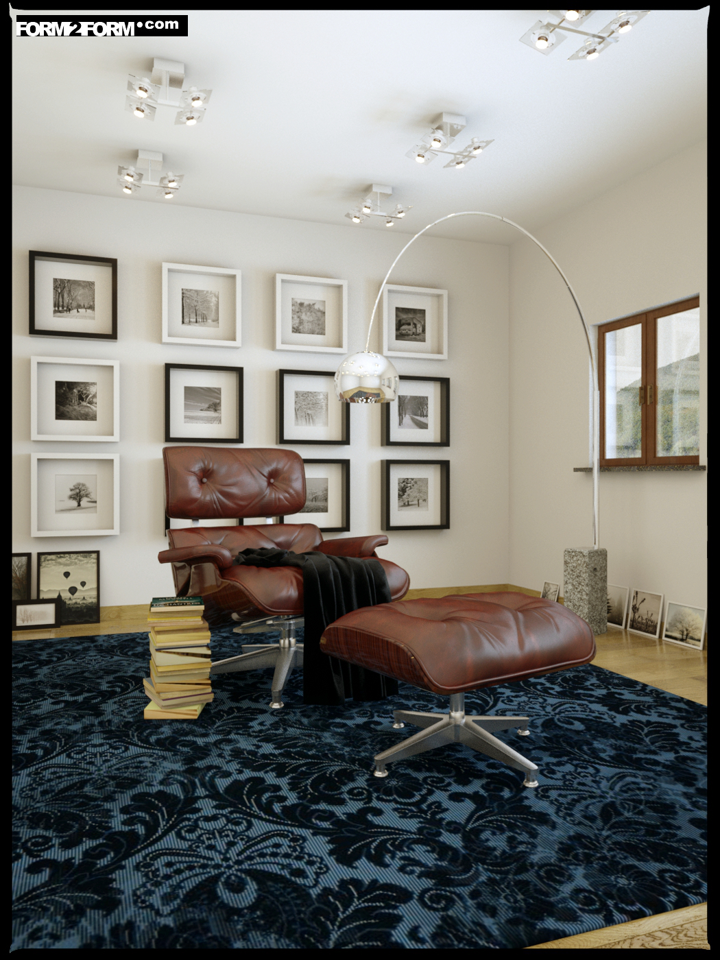

I've done this scene to test Paquito and Sakalakapaka presets. Thank You Guys!
My presets:
Render time 1400x700 - 15 minuts ( single GTX 670MX)
DL AO mode - AO Distance: 3, filter size 1,2
camera exposure: 5
outside light: texture emission white: 1
behind window material: black body, temperature 12000, power 200, opacity 0,01
postproduction: perfect effect ( vignete, color correction - warmer, ) Gimp - curve correction
All - 25 minuts of work with render and postproduction.
Best Regards
Pozdrawiam
Simple test scene
- Sakalakapaka

(Ładniutkie) Really nice effect
Leather looks perfect.
I see little noise on the windows glass. If you use small light emitters, try to use really high sample rate (10 000 or 100 000), for me, in AO mode, it works.

Nice, this looks really realistic! Cool to see something so realistic rendered with DL AO Kernel, I use it a lot too. Great work!
The only very minor thing I would maybe consider is to roughen up the metal lampshade… It looks it little mirror-effect right now.
Amazing work, congratulations!

Thanks for comments - MoGrafik You're right, lamp is too glossy.
Sakalakapaka - You're right too, there is window noise . I've tried high sample rate and picture looks better - Thanks ( dzięki i pozdrawiam ).
Best Regards
( Pozdrawiam )
Best Regards
( Pozdrawiam )
