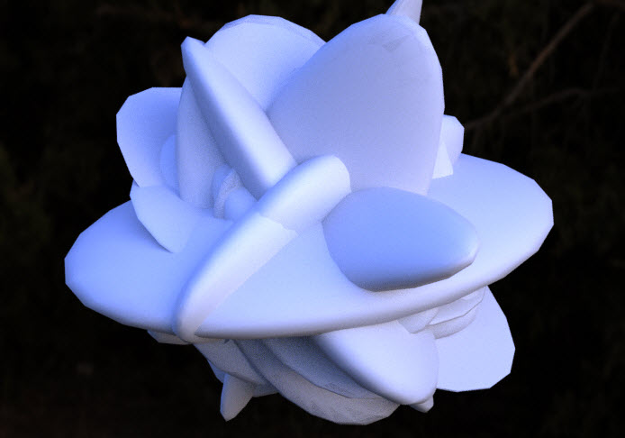

Has anyone gotten Modo CSV files to work with Octane standalone? My geometry gets skewed when I try using it and I'm not sure why. I found a script on the forums for exporting instances to a .txt file which works pretty well, but I'd like to be able to use the CSV files.

Hi - not sure how you are generating your CSV files - but if the geometry is skewed - it sounds like the scale is being applied in the wrong order to the rotation in the transformation matrix.
