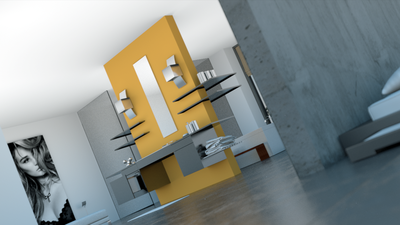

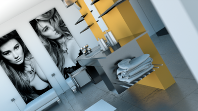

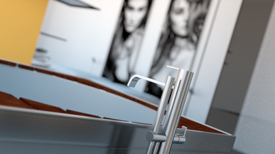

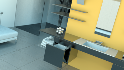

Hi Guys,
I am new to 3D, but basically a multidisciplinary designer for last 20 years.
Bathroom Design
Nice work, but the ambient occlusion make them look too blue and a bit like drawings,
maybe try the pathtracing kernel for your finals ?
Also there's some aliasing, are you using the latest beta 2.3 v5 version ? (the older beta 2.2 version can cause aliasing)

Hi, nice design
Try pathtracing, it will be much more realistic.
cheers jan
cheers jan
W7 / Quad Core Xeon E5405 / 24G / Asus ENGTX 480, 580 / http://www.allcity.cz / https://www.facebook.com/pages/Allcity/ ... e=bookmark
I am still using 2.2...this is time bound job and has to be animated so have stick to the 2.2 version as per your advise on the forum. Also I a new to 3D...you can say these are my first 3D professional renders, so not much aware of the terminology....still in learning process. They are done with direct lighting as pathtracing causes too many fireflies in the animation...will renders some test stills for my own use in 2.5 and see how it works.
