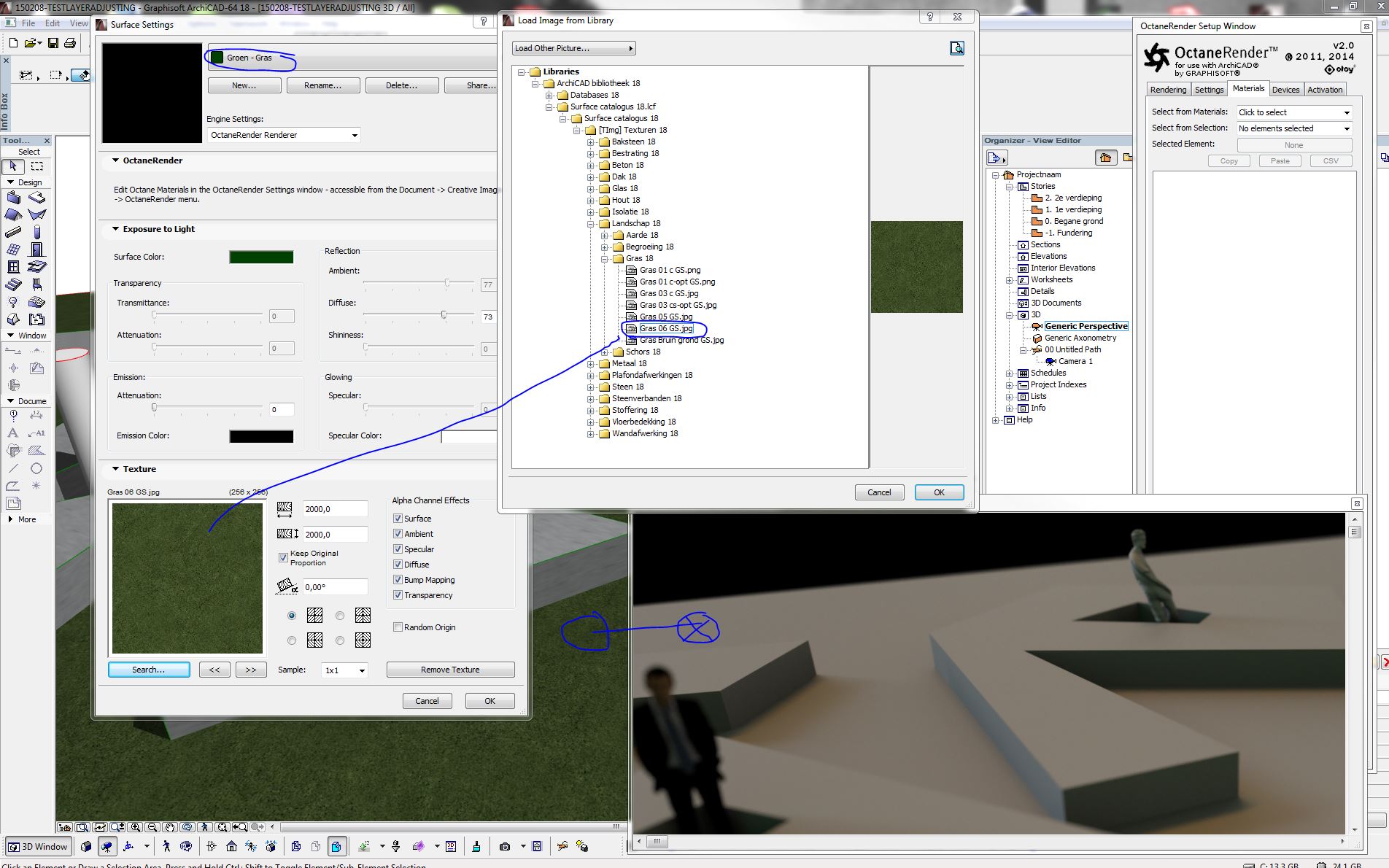

Hi Paul,
It seems the material is not transferred to the plugin?
and "Re-convert form ArchiCAD material" does not solve it
(using 2.16)
greetz, Jeroen
4090+3089ti & Quad 1080ti
http://www.tapperworks.com
face_off
Posts: 15760
Location: Adelaide, Australia
Hi Jeroen. Have you extracted the AC library into your file system? If not, there will not be a "Gras 06 GS.jpg" in the file system - it will be encoded in the lcf library where Octane cannot access it. http://render.otoy.com/manuals/ArchiCAD/?page_id=169. The plugin should pop some sort of message when this occurs. Have you checked the Octane Log?
Paul
rappet
Posts: 1962
Joined: Fri Apr 06, 2012 3:57 pm
Location: The Netherlands
Thanx, I should have known... You may RTFM me next time :oops:
