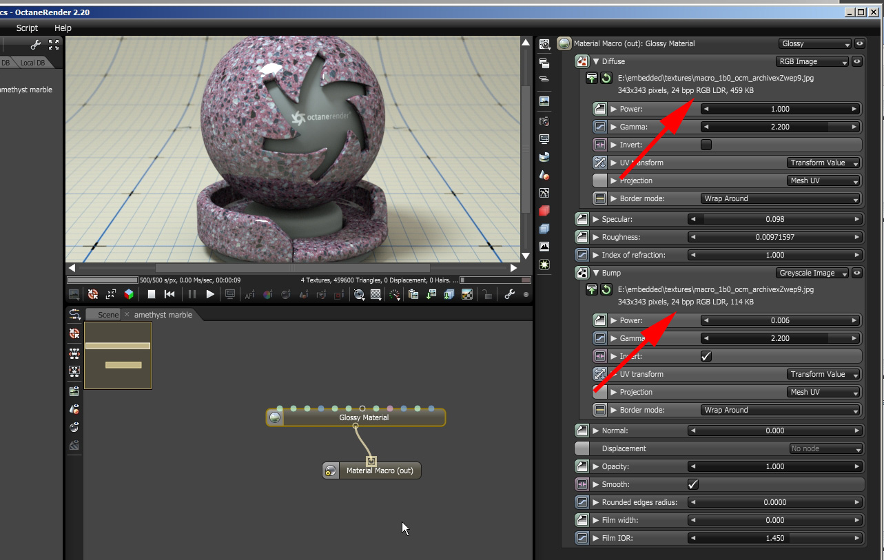

You can save the textures from the Standalone without problems: you only need to save the scene with the LiveDB materials and Standalone will store the texture files in your HD. If you want to know where the files are, you only need to reload the scene again and see the path the texture node.

Thanks Juanjo, I'm able to store the textures in LocalDB but not Live DB. However I'm not clear about your instruction - "If you want to know where the files are, you only need to reload the scene again and see the path the texture node."

After save the Standalone scene, if you reload it, you can see where are the texture files in the information available in the texture nodes.
