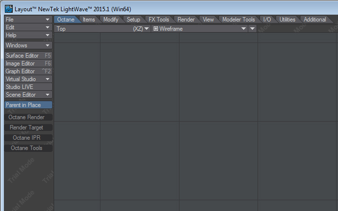

I'm currently running LW11.6 and wanted to see the Octane hair feature in LW 2015 before upgrading to it. So I have a separate installation of of LW2015 but as you can see from the image above, the plugin isn't active yet and I'm not sure why. The .p file and the dll and cfg files are installed. I've just cleared my browser cache and can now get back onto the website.
But in the image I can see the the Octane menu bar is empty, usually because the plugin is not added to the Layout. Do you know if the plugin is added to your LW 2015 layout without problems, with the message "127 plugins found in 1 file"?
