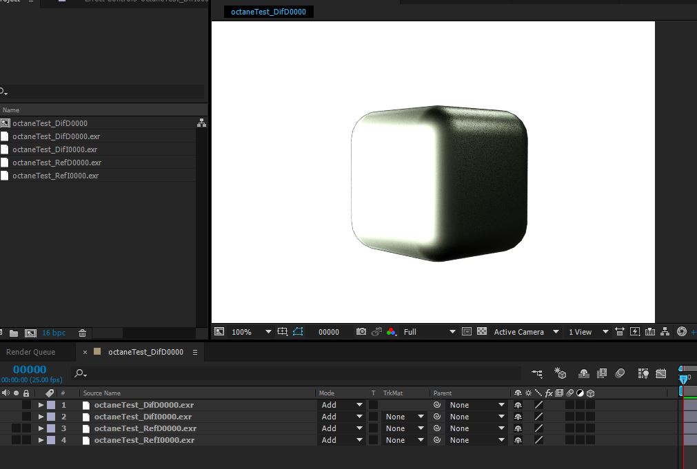

I have a basic scene with a HDRI-Environment, an Octane-camera and simple geometry. I want to render it using the different Renderpasses and comp them in After Effects on a new background. But I always get the dark border from the alpha-channel. My solution would be to render the passes with straight alpha (and add the alpha from an object-channel in the end). But I can't figure out, how to get the straight alpha...

Hm, strange. I guess I misunderstand something totally. Would be really nice if you could have a look at this scene:
It renders 4 passes. If I add them together in AE I get this black border...
Thank you!
Best, Julez
