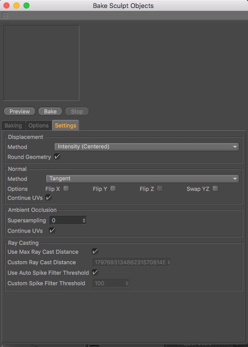

There are different types of displacement.
You'll need to bake with displacement method 'Intensity' or 'Intensity Centred' which are greyscale height-maps that you can use in Octane.
For good results, I would bake your displacement at 16bit of 32bit (you can use Open EXR 32bit with 16bit compression to keep file-size down).
Depending how close it will be to camera, you should think about higher res than 1024*1024.You may want to try with 'round geometry' checked & un-checked to see which Octane likes better.
As for normal maps, I think Cinema bakes slightly 'special' normal maps itself, although it can happily render normal maps made with any package.
You might have to try 'Tangent' & 'Object'.
Have a read of the Cinema 4D help on all these baking options, there is quite a lot of info in there.

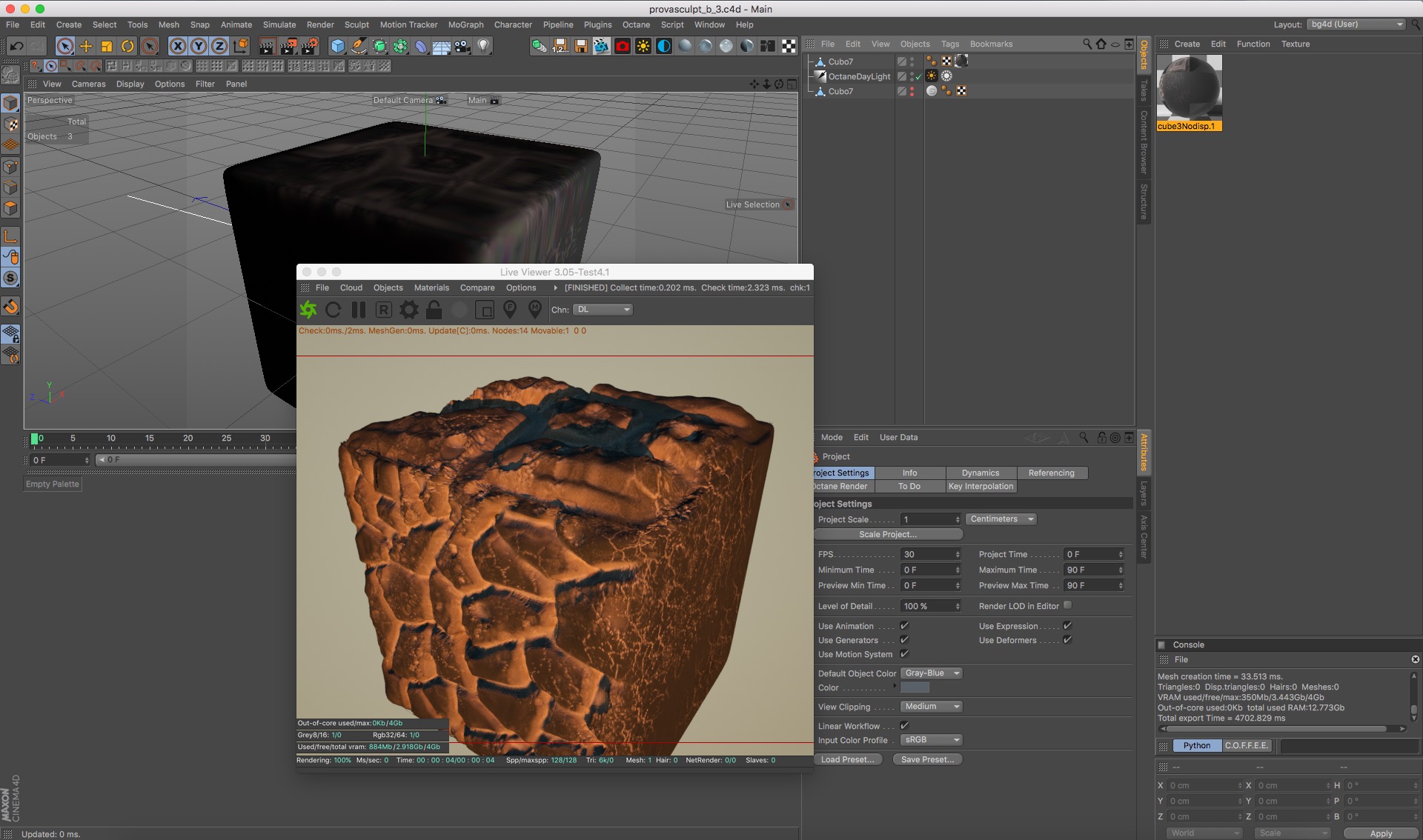

Hi aravind,
please, try with this example scene:
provasculpt_b_3.c4d.zip
(66.77 MiB) Downloaded 931 times
I have used this settings:
