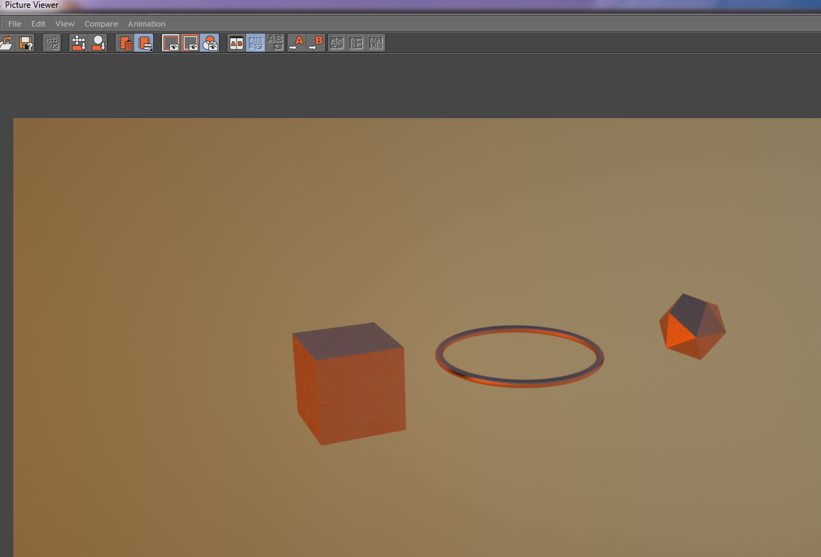

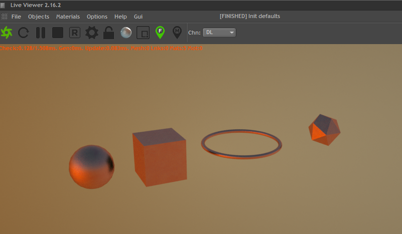

Thought I was loosing my mind. Tried this in multiple projects. Re-installed Octane. Started C4D up again. Sure enough, for some odd reason, sphere objects won't render in Octane. I've tried a few materials. Used other control objects (squares, etc.) and they render fine.
Any idea what's going on?
p.s. They render in Live Viewer just fine. Just not in final renders.

Almost solved. Please consider this a bug.
You have to uncheck "Render Perfect" in the Sphere Object settings. This was NOT a requirement in previous version of Octane. Please fix. Thanks!

TogTobias wrote:Almost solved. Please consider this a bug.
Sorry, but tired to explain about this. It's on first page of manual about limitations. Could you please read manual?
