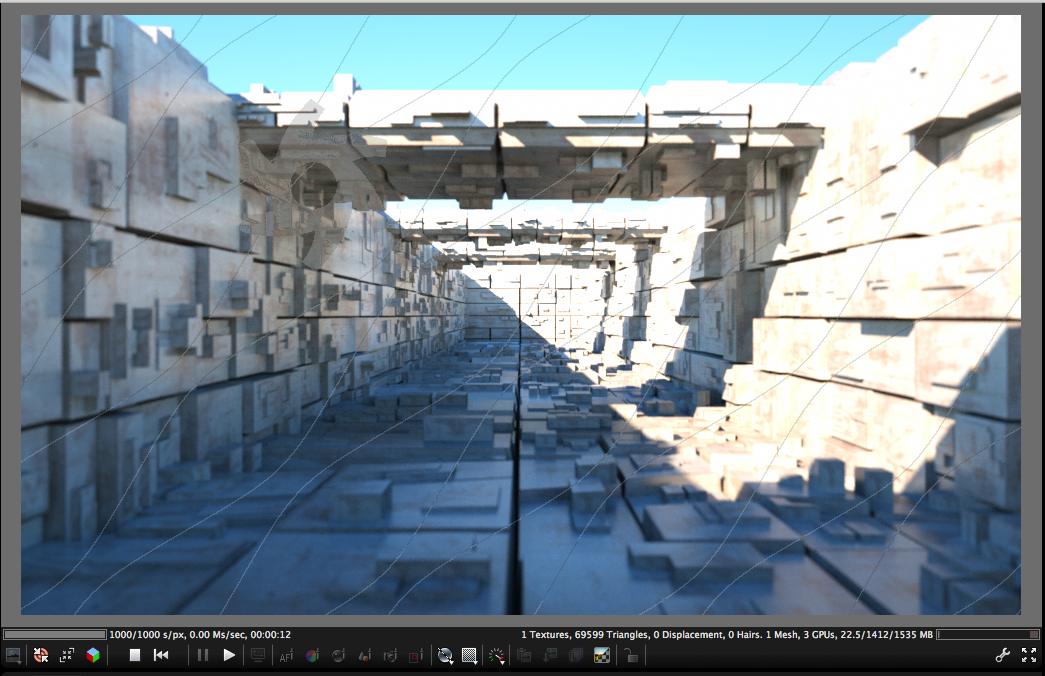

So I've spent the last 3 days getting this together...

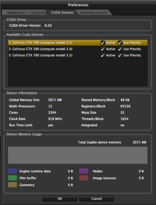

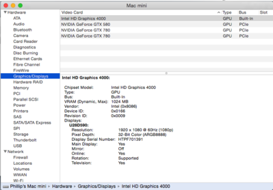

Ive come to the conclusion that no OS X machine can handle 5 GPU's.
I tried multiple configurations of GPU's with multiple methods with drivers no drivers 10.8 / 10.9 / 10.10
Ive tested 5 GPU's on a
2008 & 2010 Mac Pro - Got 4 running really well.
Mac Mini - Max 3 due to intel 4000
Macbook Pro - Max 2 due to intel 3000 & 6770m
Macbook Air - Max 3 due to intel 3000
Although Jose got 2 Titan Z's working with his iGPU its blowing my mind to think that it is and its not....
Im not sure about anyone else but 10.10.2 i could NOT get anything going not even a single card. Kept coming up as DISPLAY in graphics section...
Also maybe I'm just the retard but also couldn't modify the driver to work on 10.10.1, But the default drivers perform great.

My Opinion on getting this going (from my experience):
Get yourself TextWrangler & Latest CUDA drivers
Modify the 3 KEXT file
/System/Library/Extensions/NVDAStartup.kext/Contents/Info.plist
/System/Library/Extensions/IONDRVSupport.kext/Info.plist
/System/Library/Extensions/AppleHDA.kext/Contents/PlugIns/AppleHDAController.kext/Contents/Info.plist
Shut down your system.
Plug Thunderbolt in and turn PSU on.
Turn on your Mac.
and thats it.
