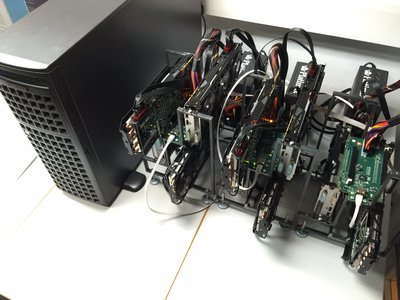

First of all You can use something like splitters to [urlhttp://amfeltec.com/products/gpu-oriented-cluster/]clusters[/url] (this one I really like as it takes care of housing GPUs & You don't have to think about how to put them!)
Downside of such solutions is that they are hooked via 1x or 4x & thus upload speed is cropped in way, but if You upload a scene once & then render for extended period, that's completely fine to live with (link speed influences only upload - rendering speed is the same as if the card would be hooked inside computer)
on the other hand there are "professional solution", like those netstor, magma, etc boxes that will be hooked from x16 - providing more speed, & they might look better..but are not as flexible & depending on cards You're using..-might not be very good in terms of cooling.
That Cluster solution if You'd be using good aftermarket coolers like Windforce, ACX, STRIX, etc.. is a good way to have not only good temps, but also relatively cheap build (a frame with all wires for 4xGPUs cos around 300-400 & two of them ~600$ =)plus PSU depending on power Your GPUs are going to take.

These Clusters really looking strange, don't they?

I do agree these clusters look weird (it was my thoughts too), but with proper cards it actually makes a lot of sense - good airflows means You get more performance too, as cards are not throttled down because of heat =)
Just be avare You'll probably hit ceilings very fast as "only" 7-8 GPUs are going to work on mayority of motherboards

I didn't know these clusters and think, that they will
be a good solution for me!
Not expensive and therefore worth a try!
With, for the moment, only "one" additional Titan-Z
I won't hit the ceiling I think! ;)
