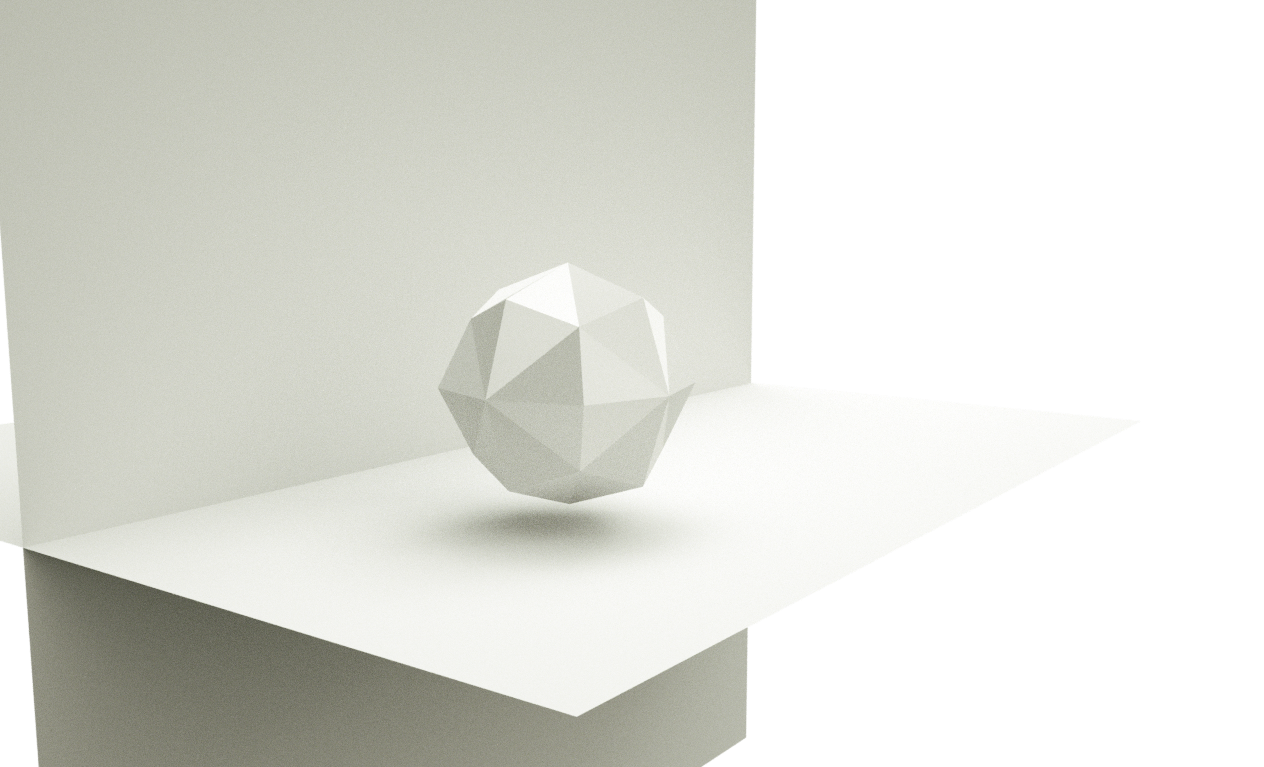

Here are some examples.
No rounded edges:
Rounded Edges = 0.0
Rounded Edges = 0.0
Rounded edges set to 0.2:
Rounded Edges = 0.2
Rounded Edges = 0.2
And this is how it should look:
Beveled at 0.2cm
Beveled at 0.2cm
abstrax
Posts: 5516
shawnfrueh wrote:Here are some examples.
No rounded edges:
On a first glance, this looks like a scaling issue. (The radius of the rounded edges is in meters) Could you send us the scene as a package?

The scale of the sphere is approximately 18.3 cm. putting the rounded edge to a smaller value does not work. Also you can see this effect on the default octane material scene.

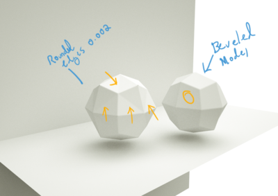

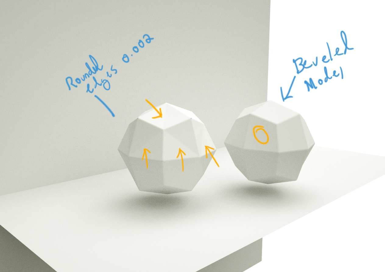

Looks like if I turn off the smooth check-box I can get the rounding that I want at 0.0017. However, I need smoothing turned on. Is this a bug or is that how it is supposed to work?
The smoothing Check-box does not work on the material preview model.
EDIT: Example
