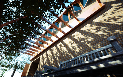

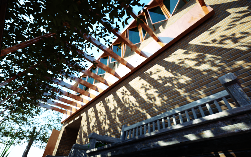

windows from below
Nice render, some remarks:
- the perspective is a bit too much, it's quite hard to make out the content of the scene without a full description
- try using alpha mapped and textured leaves (with some diffuse transmission), currently they look to geometric, too much abstract...
Yours,
Radiance
