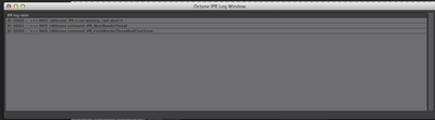

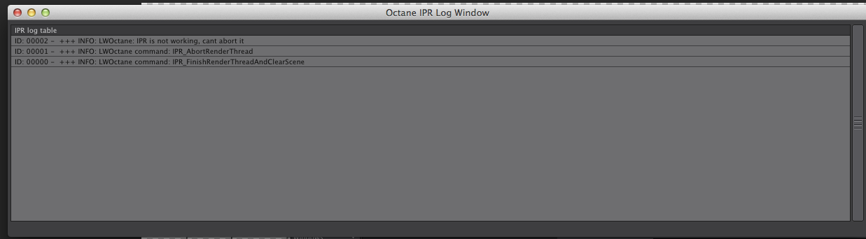

It also displayed the following messages attached as a screen cap. Don't know what I should do next

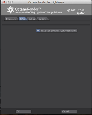

So the problem is that the plugin doesn't have GPUs available for rendering? ... can you please open the plugin options panel to see what GPUs are available?

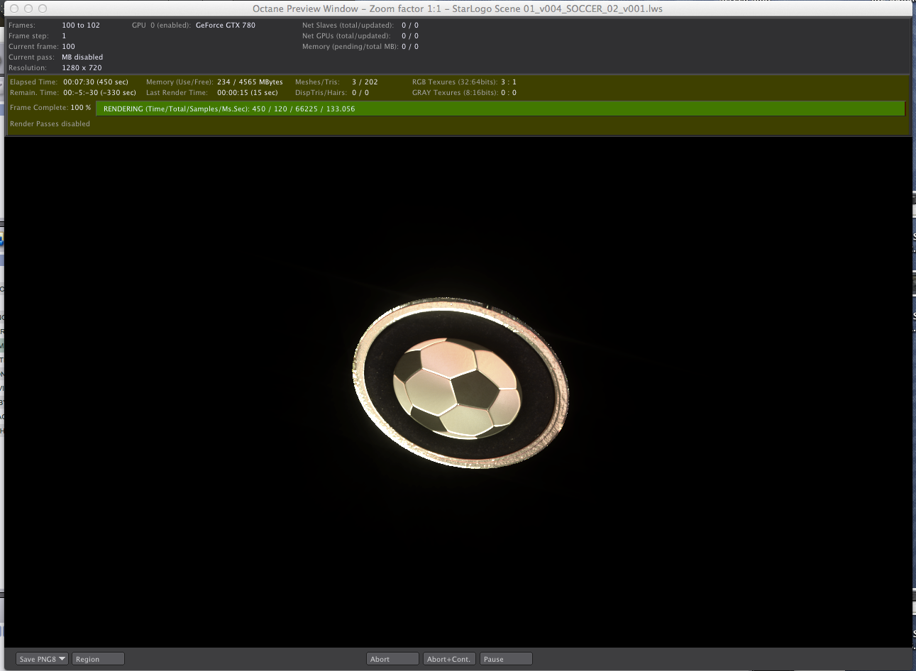

Hi again,
Well, I'm now having a new issue where the scene won't advance frames (was set to 2 minutes a frame). It just holds on the first one, and lists a negative remaining time (currently -4:50). Is there a new checkbox I might have missed?
