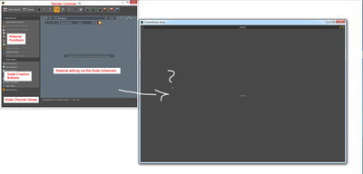

Paul,
I messed my render controls panel - how can I revert the default layout? See the screenshot.
smicha
Posts: 3151
Location: Warsaw, Poland
Can someone help me with resetting the octane render setup control panel layout? I am fighting with it for an hour.
smicha
Posts: 3151
I uninstalled the octane plugin, cleared files - no success. I still have no clue how to revert to the default layout.
face_off
Posts: 15714
Location: Adelaide, Australia
Delete the Modo801.cfg file.
Paul
smicha
Posts: 3151
Thanks Paul. That is what I did (2 hours of despair :lol: ).
Just a small suggestion - is it possible to add extra option to reset the layout settings to default?
